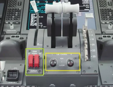

Earlier, there was STAB POS XDCR message for Stabillier Position Transducer, which was troubleshooted.
STAB trim switch is in control column & thumb operated,
but red color guarded toggle switch for STAB on-cutoff are beside the fuel switches.⚠️
So where exactly was the issue?
- Transducer
- wiring
- connector
- switch
- something in TCB box?
From the message it appears that the Transducer is faulty, but a bad connector or wiring on either end MIGHT also produce this error.
An Electronics &/or Electrical engineer can tell best.
What exactly was troubleshooted?
Was something replaced like Stab Transducer, connector, wiring, Stab trim switch, stab on-off switch beside the fuel switches?
These 2 switches of Stab & fuel clearly seen to be 2 units with fixing screws. But still, can there be a short circuit in TCB box in or around Stab on-off switch, which also affected the Fuel switches?⚠️🚨🤔
