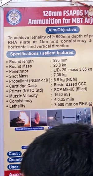

120mm FSAPDS Mk-2 Ammunition brochure from Vigyan Vaibhav 2025
Specifications / Salient features :
• Round length : 996 mm
• Round Mass : 20.8 kg
• Penetrator : L/D 20, Mass 3.65 kg
• Shot Mass : 7.30 kg
• Propellant (NQ/M-110) : 8.5 kg (NCM)
• Cartridge Case : Resin Based CCC
• Primer (NATO std) : SC0 Mk-IIC (filled)
• Muzzle Velocity : 1660m/s
• Consistency : ≤ 0.35 mils
• Lethality : ≥ 500mm RHA @ 2km

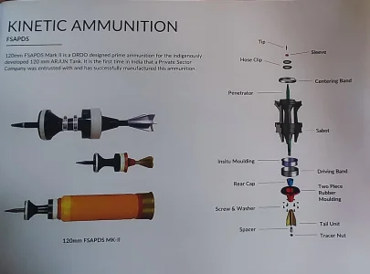

120mm FSAPDS Mk-2 Ammunition brochure (Origin Unknown)
120mm FSAPDS Mark-II is a DRDO designed prime ammunition for the indigenously developed 120mm ARJUN tank. It is the first time in India that a private sector company was entrusted with and has successfully manufactured this ammunition

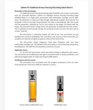

120mm FSAPDS Mk-2 Ammunition downloadable document from DRDO website
120mm Fin Stabilised Armour Piercing Discarding Sabot Mark-II
Description of the technology :
Fin Stabilised Armour Piercing Discarding Sabot (FSAPDS) is the primary ammunitionwith any armoured regiment. 120mm Fin Stabilised Armour Piercing Discarding Sabot (FSAPDS) Mark-II is a single piece ammunition with combustible cartridge case for MBT Arjun. The penetrator is made up of high strength, high density tungsten alloy material. The projectile is fired at very high muzzle velocity. The sabot is discarded just after the muzzle and the penetrator, stabilised by Tail fin unit, travels to the target. On impact with the target, the enormous kinetic energy forces the penetrator to perforate the tank armour. This is sufficient to permanently damage the essentials of tank and harm the tank crew to achieve ‘Total Kill’.
The ammunition is extremely reliable and safe to use. The ammunition has got excellent first round hit probability. The consistency and accuracy of the ammunition are excellent and meet the stringent acceptance criteria of the Indian Army.
The ammunition utilises indigenous Triple Base Propellant with resin base combustible cartridge case. The lethality of the ammunition is much enhanced compared to its predecessor. The shelf life of ammunition is minimum 10 years.
Application Areas :
It is an anti-tank ammunition, which uses Kinetic Energy to defeat the tank armour. The ammunition can be effectively used against all present tanks in service worldwide. It can effectively engage targets at ranges even beyond 2000 meters.
Certifications and test results :
The ammunition has successfully met the stringent acceptance criteria of Indian Army during User Trials and is ready for induction in service

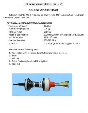

120mm FSAPDS Mk-ll Shot
120 mm FSAPDS Mk-ll Projectile is new version MBT Ammunition, fired from Rifled Bore (Arjun) Tank Gun.
PHYSICAL and PERFORMANCE CHARACTERISTICS
• Total mass Of round : 20.0 kgs
• Mass empty projectile : 7.1 kgs
• Effective range : 2000 m
• Depth of penetration : 500mm (230mm RHA Plate at 63° & 2000m)
• Muzzle velocity : 1670 m/s max.
• Chamber Pressure : 560-580 Mpa
• Accuracy : 0.30 mils (at effective range Of 2000m)
The shot has the following parts :
1. Penetrator (With increased Length/Diameter ratio) assembly
2. Sabot
3. Unit
4. Nylon Centering Band and Driving Band
5. Rear cap
