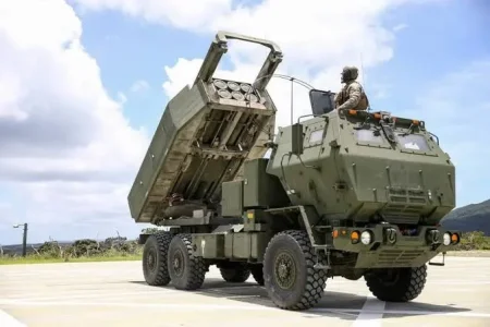

One criteria is the system should fire in-service rockets/ under development for in-service ammunition. We have Pinaka, guided pinaka, Pinaka 2, ER etc under development/in-service. Highly doubt any foreign system would allow such integration of under development indigenous ammunition.
Don't know about 6x6 vehicle. Else would have said this RFI is tailored made for new pinaka variants.
One thing to note is number of rockets each truck should carry is not mentioned. So there can be case of 6x6 pinaka carrying a single pod (6 missiles) similar to those 6x6 Himars configuration.

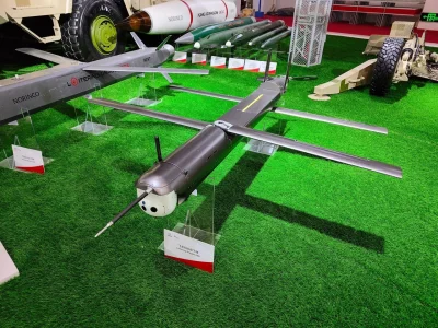

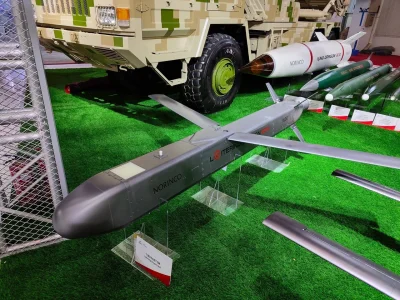

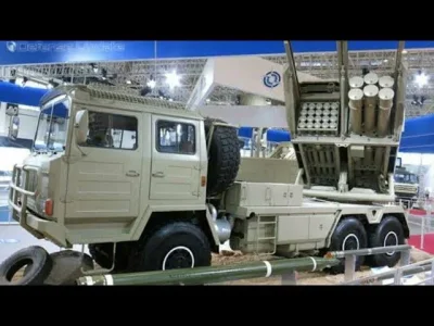

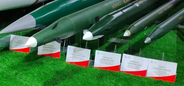

Chinese literally have the perfect MLRS for these requirements, I present you SR5 MLRS
Can fire, 122mm, 200mm+ and 300mm rockets as well. Can use loitering munitions including jet powered, a huge ass 610mm ballistic missile short range, an anti ship missile and a small land attack cruise missile.
My dream for Indian artillery and rocket force to have medium MLRS like SR5 and heavy MLRS like PHL16.
We are a quarter way there with Pinaka, just need to make ATACMS like missile for it and dedicated loitering munitions. Probably need to work on making it self sufficient to work in single unit mode instead of whole battery to reduce signature on battlefield just like mobile launcher for Pralay where comms are integrated within launch vehicle.
