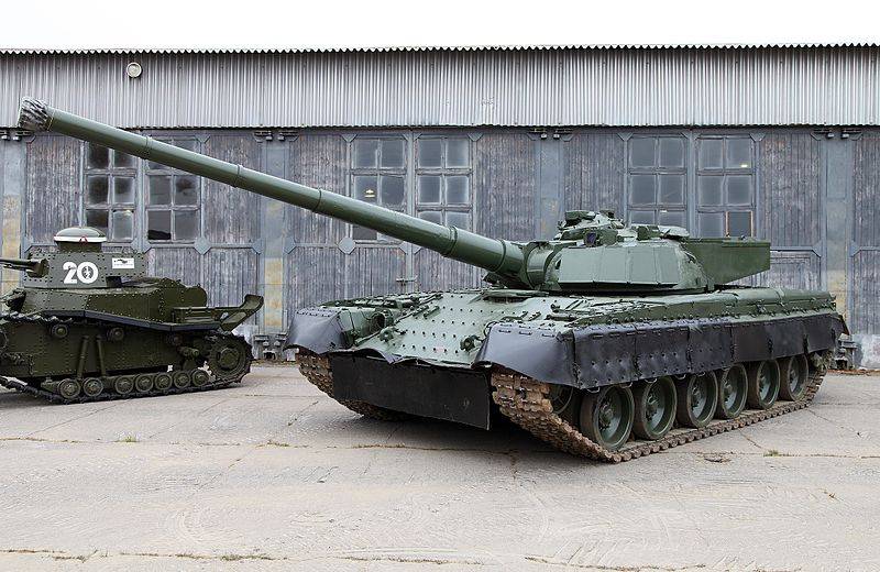

This above diagram explains why Soviet engineers were so fixated on round shaped turrets - because it presented a much smaller target to the enemy even when traversed to the side.
This was a lesson learned from WW2 as analysis of knocked out tanks showed that the turret was the one most likely to get hit.
Apart from that, a longer turret with an isolated ammunition compartment at the rear would also be much heavier, not just because it is larger but because it has a greater surface area that needs to be covered with more armor, as can be seen in the following diagram -

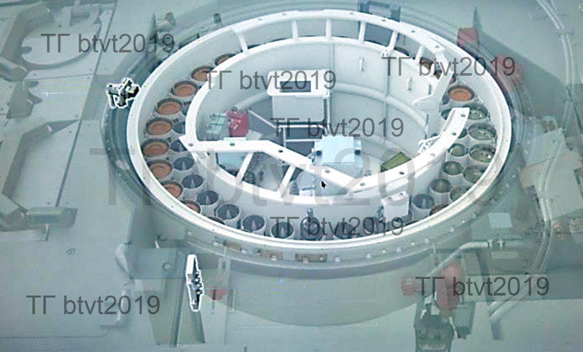

Yeah, I see that now, although the two-piece ammo is less of a problem in the T-14 as in this new autoloader, they have the whole height of the hull to play with unlike the autoloaders in the older T-series MBTs.
Definitely it'll be bigger than the cramped rounds in MZ/AZ auto-loader given now you've the whole length from turret basket to the top to play with...but, there's a catch.
The rounds are stored perpendicular to the breech so before shoving it in you must rotate the round to a neer horizontal position all while lifting it up. If the round is made too long then it'll either hit the turret roof or the beech block while it's getting rotated. And to make things worse they decided to store the rounds in the inner circle rather than the other, by reducing this radius the potential maximum length of the round too got reduced.
So ultimately a very small increment with absolutely no growth potential to bigger 130mm or 140mm rounds as on contemporaries.
But in case of the current and upcoming bustle type auto-loader you simply need just two very simple motions...a conveyor belt moves in XY plane and then the round is simply yeeted in the Z-axis. Technically you can even chamber an ICBM if you want. Technically though
Again, correct, but that tiny window is still a weak spot and a hazard as compared to a thick solid bulkhead, even if less so than a blast door found on the Leopards and Abrams.
