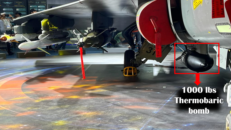

I've asked around a lot regarding this during when I was helping Kuntal model the Tejas & Mark2... The HSLD is longer & doesn't fit Jaguar's tandem carrier. The old bombs will remain till remains in service, for massed groud-attack. Takes lesser space.
The HSLD is much lower drag & we use it in future. Currently lighter jet doing a bomb run with lesser payload uses it for efficiency. Such runs thus happen to be smaller target orientedView attachment 16417
Sudarshan beard on the older bomb has been discarded because of same reasons, excessive drag & vibration at high speeds. Going ahead we'll be using either of the two below.
View attachment 16418View attachment 16419

Hopefully DRDO also make TB composition for HSLD and GP bomb casings as well. For now it has limited to old 1000lbs bomb casings.
