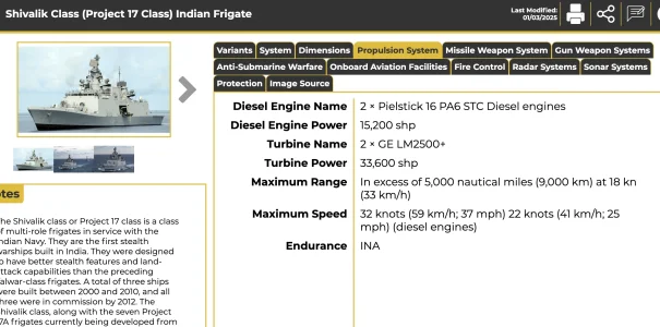

Even P17 (Shivalik, CODAG) top speed is listed as 32 knots with 2 LM2500+ and 22 knots on diesel.
