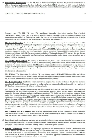

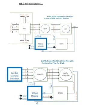

CABS has developed 𝗔𝗜/𝗠𝗟 𝗕𝗮𝘀𝗲𝗱 𝗥𝗲𝗮𝗹 𝘁𝗶𝗺𝗲 𝗗𝗮𝘁𝗮 𝗔𝗻𝗮𝗹𝘆𝘀𝗶𝘀 𝗦𝘆𝘀𝘁𝗲𝗺 𝗳𝗼𝗿 𝗘𝗦𝗠
Artificial Intelligence / Machine Learning based Real Time Data Analysis System for ESM (REDAS-ESM) is required to achieve & adapt the expected performance of ESM system as per operational requirement. As we move
to digital technologies in ESM/RWR system designs, challenges due to adaptive, agile, ambiguous, and
out of known library emitters are becoming more complex for the ESM systems. Even more complex processing is required to localize these emitters based on received ELINT/ESM inputs. The scope of the REDAS-ESM modules(software & Hardware) to assure as solution for such complex scenario this includes AI based “Real-time Data Analysis System for ESM” (REDAS-ESM) with support for both Online Real-time and Offline processing support.
The design and implementation of REDAS-ESM shall be complex Neural Networks based Deep Learning algorithms to not only classify and accurately localize varied emitters but also provides deep insights about the functioning peculiarities of various ground and airborne radars. As a result, even radar emitter’s transient behavior between two distinct modes of operations, is very accurately mapped, which hitherto was unrecognizable. The firm shall create a self-evolving AI model, with inherent spatial and temporal awareness. Internal knowledge state and decision support outcomes presented using highly intuitive Human-Machine Interface (HMI) based on advanced Explainable AI (XAI) principles. REDAS-ESM shall contain plethora of technical and operational reports provided using 2D/3D display on Geographical Information System (GIS).
The input data is processed using proven deep neural learning networks to independently generate Emitter Parameter List (EPL) with emitter details in standardized format. Where
Nav parameters and per-channel amplitude and / or phase information is available, REDAS-ESM independently
computes DOA for each pulse and uses it to compute Location Fix (LF)for each declared emitter. The system is capable
of generating both RF and digital outputs at each stage of processing which include both RF waveforms generated by the inbuilt DAC as well as digital IQ, computed PDW, EPL and LF information in standardized format for
consumption by external systems. Cumulative information is used by REDAS-ESM to evaluate external system
accuracies as well as for AI incremental learning.

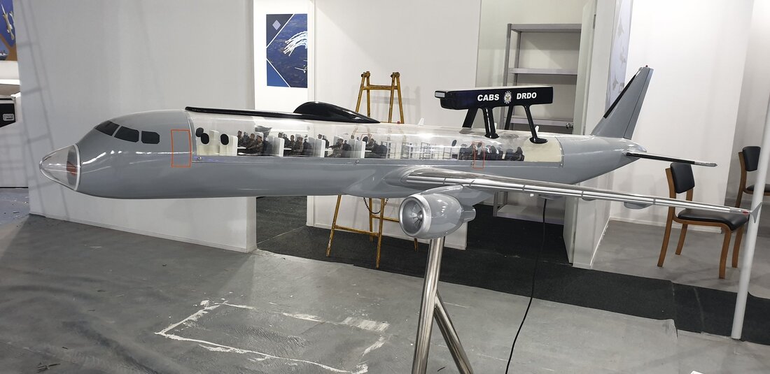

The development of an indigenous Airborne Early Warning and Control System (AEW&C) was taken up by DRDO & IAF in 2004.
Development of indigenous AEW&C system as a mission mode programme commenced with Centre for Airborne Systems (CABS), Bengaluru, as the nodal agency. After the sanction of the programme, IAF revised the operational requirements in tune with their emerging war fighting scenario. The revised operational requirement necessitated building of an AEW&C system on a small aircraft with all the systems and functionalities similar to that of the bigger AWACS being procured by IAF. DRDO took up the challenge and has made the system a reality.
The AEW&C aircraft is a derivative of Embraer ERJ-145 extensively modified and customized to house the indigenous mission systems developed in India. The complete integration of the mission system and its flight evaluation has been carried out in India. One of the main features of the aircraft is that it is the Embraer executive jet aircraft to have air to air refueling.
The system was envisaged to have full net centric capability through multiple LOS and Satellite Communication Data links, on-board Mission Computer, which enables the operator to carry out the information fusion, mission control, and reconfigurable operator consoles for the operator to interact with the system and exploit the system capabilities in tune with the operational environment.
The AEW&C system is a system of systems having primary radar (PR), secondary surveillance radar (SSR), electronic support measure, communication support measure (CSM), ‘C’- Band Data Link (CBDL), ‘Ku’- Band SATCOM data link (KBDL), V/UHF communication link working in the microwave region.
The Indian AEW&C system is versatile in choice of the sub-systems and its capabilities.

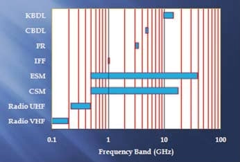

  • Electronic Support Measure (ESM) and Communication Support Measure (CSM) for detection of hostile air defenses
  • Satcom & line of sight Voice and Data Communication System
  • Self-protection Suite (SPS) consisting of UV-based Missile Approach Warning Sensor (MAWS) and Radar Warning Receiver (RWR).
  • Mission Communication System for Air-to-Air, Air-to-Ground V/UHF voice
  • Satellite-based Non Line-of-Sight Communication and Data Link.
  • C band Line-of-Sight Communication and Data Link.

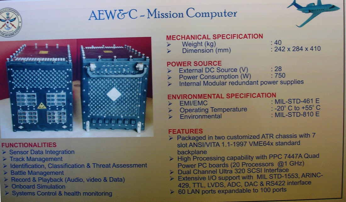

  • Mission Computer
All the above systems are electrically and functionally integrated through a high speed LAN and complete suite of tactical software fully developed in house. This software provides functionalities such as multi sensor tracking and data fusion, multi target tracking, identification and classification, system control and monitoring interception and battle management functions, all of which are developed in house. A comprehensive Human Machine Interface again developed in house, projects the real-time air situation picture, into five reconfigurable consoles, in a manner required by the individual operators. In addition to the airborne complement, five major ground systems supporting all aspects of planning, training, maintenance, and integration with IAF Command and Control Centre also have been developed fully indigenously.

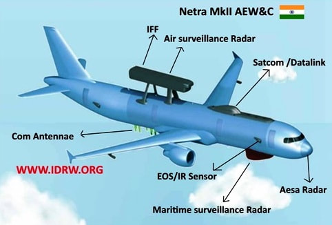

Sensor arrangement
In AEW&C, the real estate available on board the aircraft is limited and hence antennae are to be kept in close proximity to each other. On the exterior of the AEW&C aircraft, there are 89 antennae and sensors located in a cramped condition. In addition, aircraft body being metallic, the individual antenna radiation pattern gets distorted due to ‘body effect’. Hence, prior knowledge of the individual antenna radiation pattern alone cannot help while selecting suitable locations on the exterior of the aircraft for various antennae. Moreover, aircraft safety being of the highest priority, the ideal location requirement from antenna radiation pattern point of view has to take a back seat. The first step toward location identification is to predict the antenna radiation pattern with ‘body effects’. For this, one has to resort to any of the computational electro-magnetic methods. Commercial tools such as E-Mind have been used for this. This exercise is recitative and time consuming. Depending upon the number of locations tried for each antenna, one generates voluminous data.
In general the antenna location process went through the following steps:
  • No location on the control surfaces.
  • No location that affects air flow over the control surfaces.
  • No location that blocks the air in-take.
  • No location that leads debris into the engine during bird strike
  • No location that interferes with aircraft controls.
  • No location that does not have structure to support the antenna
  • No location that burns the other mission system front- end
  • Preferably locations not affecting the cooling for other mission systems
  • Preferably locations not affecting field of view of other mission systems
  • Preferably locations not affecting the performance of other systems.
The location of the SATCOM radome adjusted forward to allow sufficient air for the active antenna array unit located in the rear under all ‘angle-of-attack’ conditions. Similarly, the AAAU itself was moved forward to avoid damage from a possible broken engine blade leading to a flight hazard. Additional fins had to be added to stabilize the aircraft under ‘side-slip’ conditions as there was a blockage of air to the control surface.

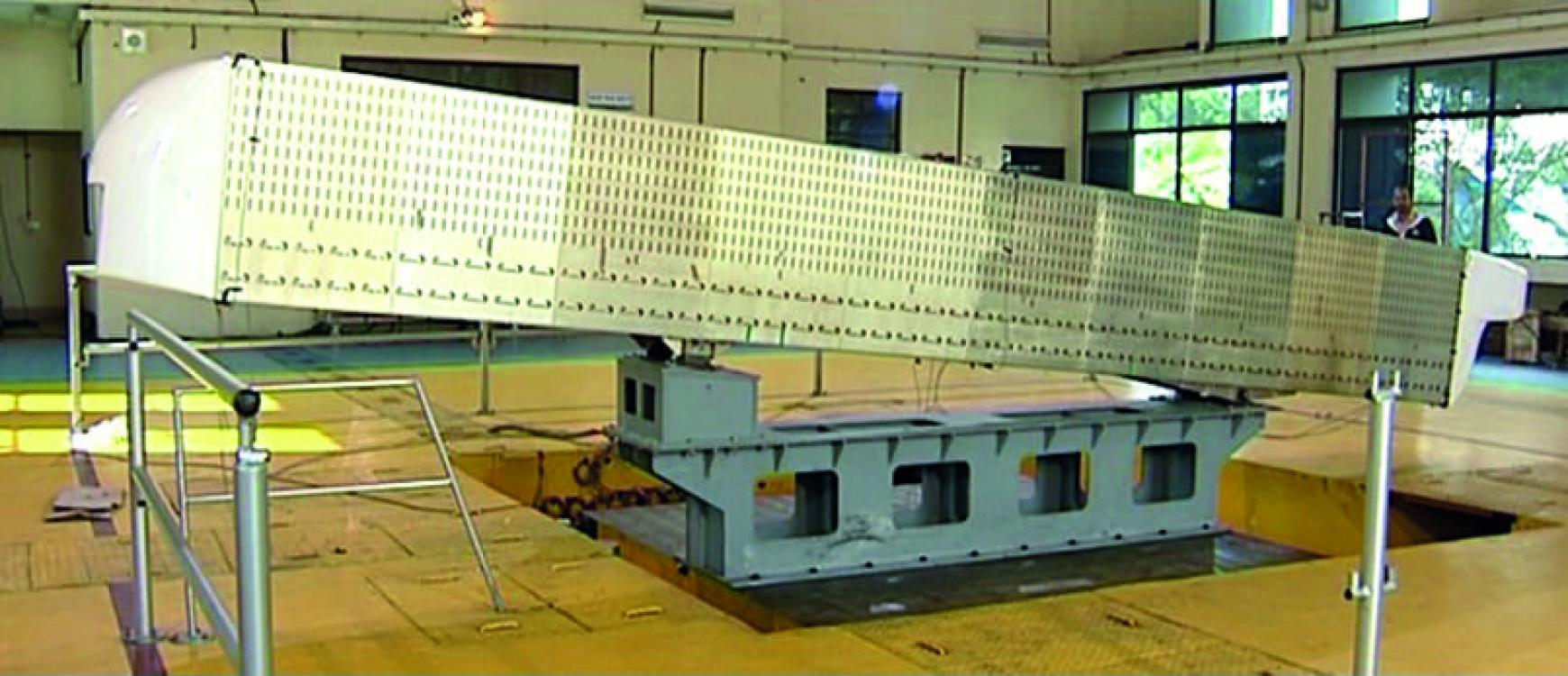

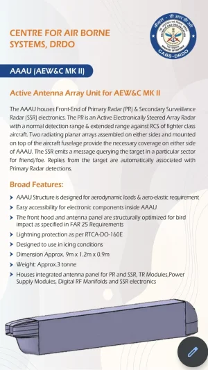

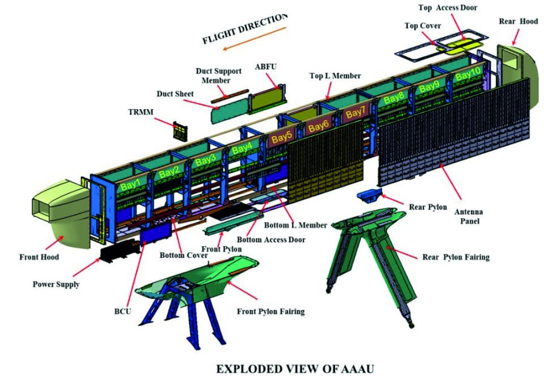

Active Antenna Array Unit (AAAU) is a major as well as critical component of the AEW&C system and has been indigenously developed.
AAAU is an active electronically scanned array (AESA)-based radar having more than 1,000 elements producing several tens of kilo watts of power.
The AAAU is mounted on dorsal side of the aircraft fuselage using four pylons. Being an external structure of an aircraft with the dimensions of 8.2m X 0.9m X 0.5m, it qualified stringent airworthiness requirements.
AAAU structure is designed for aerodynamic loads, inertia loads and aero-elastic requirements. The mechanical design of AAAU is designed considering easy accessibility for various electronic components (LRUs) inside the AAAU. The fool proof design of AAAU caters for antenna structure, thermal, microwave electronics & digital electronics. Wind tunnel tests and CFD studies were conducted for the AAAU to optimize the aerodynamic shape of front and rear hood and to estimate the internal and external aerodynamic loads. Structural tests such as Modal Analysis Test (MAT), Static Strength Test (SST) and Ground Vibration Test (GVT) were conducted and validated with Finite Element Analysis.
Internal design is made to optimize the cable routing, for accommodation of front end electronics of primary & secondary surveillance radars and cooling of them.
This design, using ram air for cooling the electronics inside the AAAU, reduces the burden on the cooling system virtually to one third and consequently the power that is required for cooling is also reduced. The front hood and antenna panels were structurally optimized, tested and certified for bird impact requirements specified in Federal Aviation Regulation (FAR– 25).
AEW&C Active Electronic Array Antenna
AAAU in PNFM facility.​
The radar offers multifunction, multi-mode capability with highly agile beam steering and electronic beam stabilization by the array.
Radiating interface, the major subsystem of the PR Active Electronically Scanned Array (AESA), is first of its kind. To obtain higher sensitivity, the AAAU is designed with high power transmit capability and also achieved ultra-low side lobe level in the receive mode.
The AAAU array has been developed with amalgamation of analog and digital electronics, microwave & electrical technologies. Its sophisticated electrical power distribution system comprises multiple safety measures. The performance of the array is maintained by in-situ calibration system.

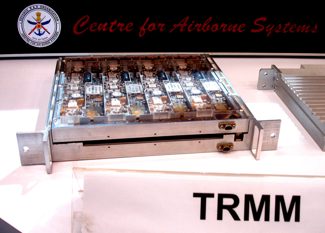

Critical building blocks that supports all functional requirements of the radar and serves as heart of the AAAU system are TRMMs.
The TRMM’s have RF and digital manifolds to accommodate the size and weight due to its unique design. The unique design of integrated antenna aperture for both primary and secondary surveillance system along with cladded radome reduces the weight and volume constraints. This uniqueness has also helped in bringing out the microwave losses thus making it a win-win from both structural and electronics aspects. With the aid of several stages of RF distributer and combiner networks, single RF signal input is fed to all elements of planar array. The received signals from all elements are combined by the TR modules and stages of RF combiners.
To achieve the command & control of installed LRU’s of AAAU system a controller has been devised with required hardware and software. The unit accepts the control and commands information from central unit/IFF SP/MSC through specific interfaces and distributes the same to AAAU LRU’s.
DRDO-designed S-band TRMM
AAAU Exploded view
Astra Microwave-assembled TRMMs
The bottom portion of the AAAU contains the Multi-output power supplies (MOPS) that require more cooling than the TR modules that are placed in the middle. The internal airflow for each of the 160 Transmit-receive multi-modules (TRMM) should be not less than 15 CFM even under blockage conditions due to the presence of SATCOM radome under all pitch- and yaw-conditions. To assess the required quantum of airflow, wind tunnel tests were carried out apart from CFD analysis. The system has about 2 km length of RF cables in the air passage.

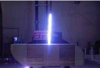

Another special requirement for the airborne antenna is that it has to pass the lightning test for both direct and indirect effects. After zonal analysis, the lightning attachment points are identified and provided with paths for lightning to pass through without causing any structural damage. The indirect effects can be equally damaging like direct effects on items like the TRMM with sensitive electronics. The lightning must be discharged as much as possible by limiting the current flow in the skin. A waveguide slot array is best suited for this environment. Similarly, the SATCOM radome in the lightning prone zone has button/strip type lightning conductors to retard the lightning effect.
Lightning test

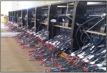

The most critical technology element for the radar is the Transmit-receive multi-module (TRMM). Design of the TRMM was carried out in the microwave lab and evaluated in detail. The most difficult part of the design was thermal management of the components in the TRMM without giving rise to hot spots by usage of ram-air-cooling.
RF cables in the AAAU.​

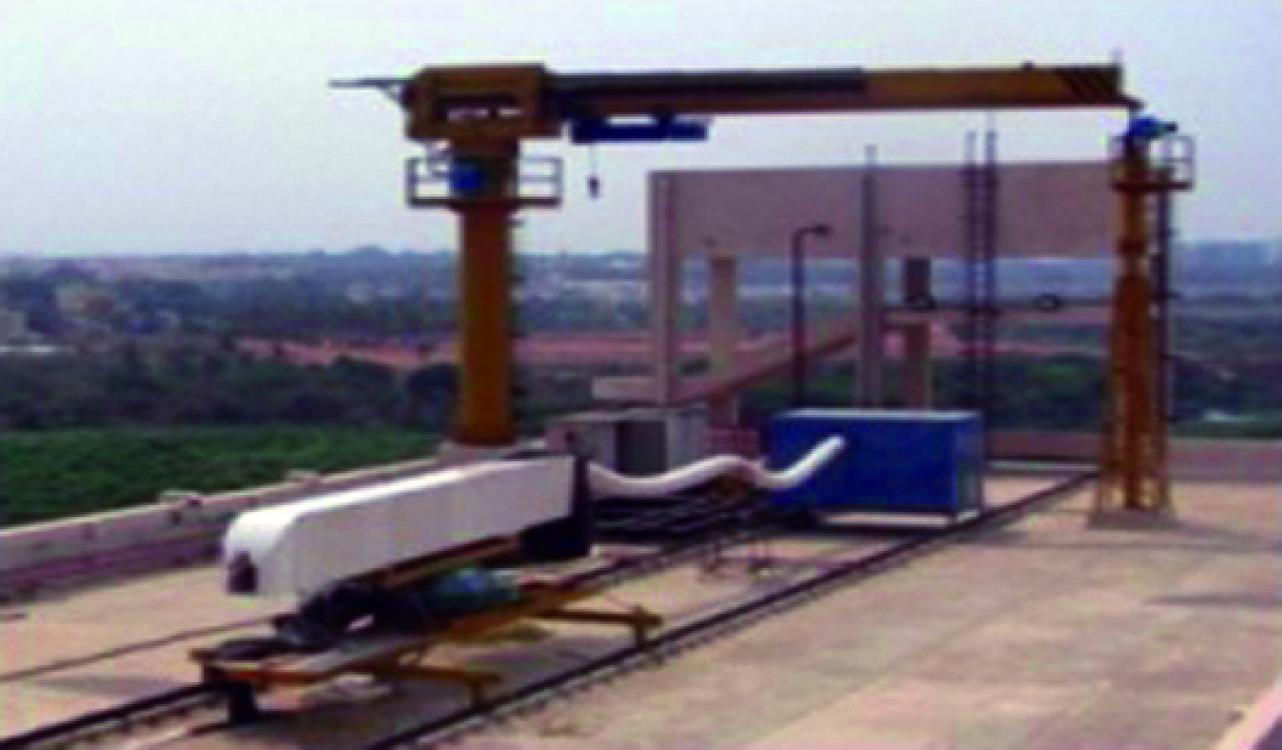

AAAU in Rail Track Rocket Sled facility

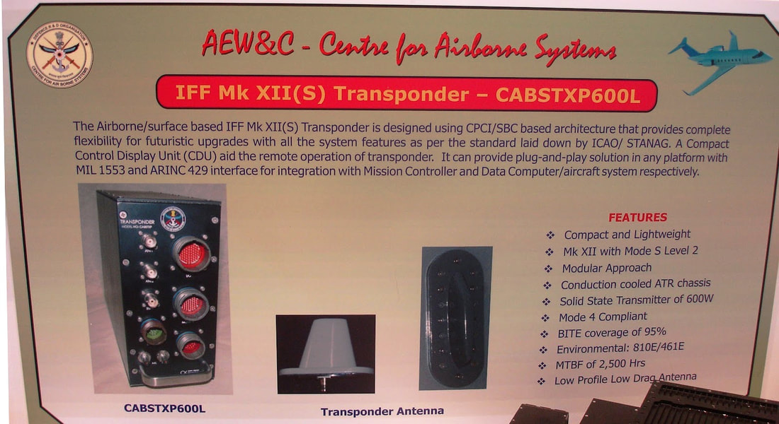

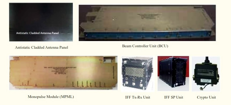

Secondary Surveillance Radar
Secondary Surveillance Radar (SSR) is another important sensor in AEW&C system used for detecting targets, identification as a friend or foe while working in tandem with Primary Radar (PR). This information is very vital in the wartime and is also useful to form database during peace time surveillance.
SSR system also called Identification Friend or Foe (IFF) system in military terminology comprises of an interrogator fitted with the main radar system on airborne platform and a transponder fitted on target aircraft. It operates as per the recommendations of the International Civil Aviation Organisation (ICAO) and STANAG 4193.
The interrogator transmits pulsed signal in a particular mode of interrogation in a specified direction. Aircraft fitted with compatible transponder receives the interrogation signal and replies back in the form of another coded signal to the interrogator for processing and identification. The reply provides additional target details such as height, range and azimuth, and target status like communication failure, emergency and hijack. Mode 4 is an encrypted mode of operation that enhances its capability to be secured, jam resistant and resistant to spoofing. Operation in Mode S (level 2) gives capability of selective addressing and data link capability, which are very critical in dense air traffic.
Based on the requirements of the user and platform constraint, the high power airborne IFF MK XII(S) interrogator has been developed for the AEW&C programme with a range of more than 475 km using modular approach. It comprises of Electronically Scanned Antenna Array (ESAA), solid-state transmitter, dual channel monopulse receiver and signal processor.
All the LRUs of IFF system have been qualified as per the MIL-STD 810E/461E/704D and certified for airworthiness by CEMILAC, and has been thoroughly tested in System Test & Integration Rig. More than 700 user evaluations were carried out by AFPT and ASTE including Large Fleet Engagement (LFE) sorties at various places in India. Formal ATP has been carried out by the IAF task team. Two IFF systems with adequate spare have been inducted into the IAF.
Identification Friend or Foe (IFF) MK XII (S) with Mode 4 Capability

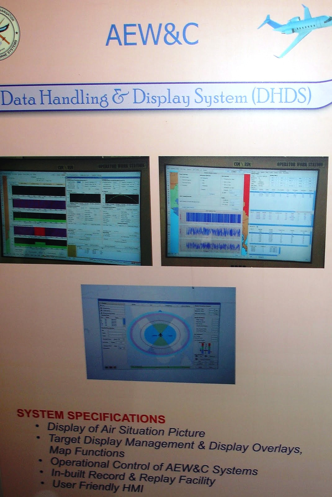

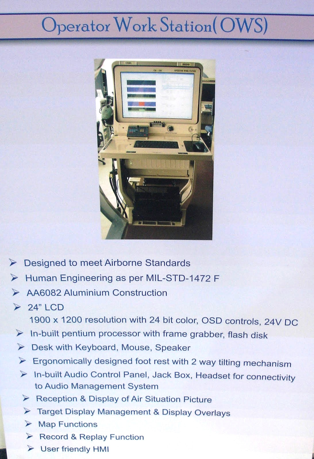

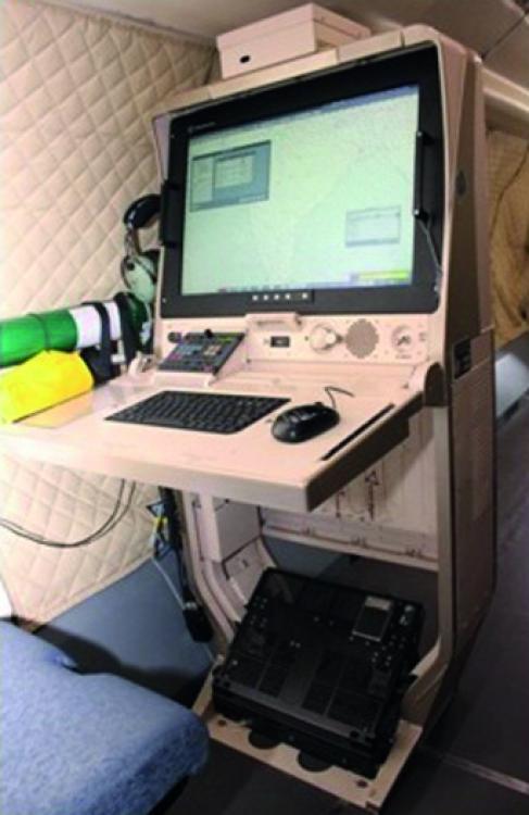

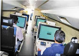

Operator Work Station
The face of the AEW&C system through which the operators interact with the Mission Systems onboard is the Operator Work Station (OWS).
An operator deals with complex and large amounts of data and OWS provides better data organization, processing and distribution of actionable information, improving efficiency and reducing the reaction time
CABS in house developed OWS provides the operator a real-time display of the integrated tactical air situation picture on a powerful and ergonomically designed HMI, which enables the operators to gain a better situational awareness of the region under surveillance. There are rugged and lightweight five front facing airborne qualified operator consoles onboard.
Each OWS receives tracks, plots and emitter data from radar, IFF, ESM & CSM systems via the Mission System Controller (MSC) and provides an Air Situation Picture (ASP) to the operator. The OWS has a lightweight map engine capable of rendering both vector maps and raster maps. It supports multiple projection and coordinate systems and allows the operator to select the map layers such as coast lines, roads, and towns of his choice. To aid in operations the data received through the sensors are presented to the operator in different formats like symbols, textual windows, histograms, spectrum display, waterfall display etc.
The OWS provides capability of initiating interception of a hostile target, reception of the interceptor guidance solutions and commands from the MSC, facility for manual correlation of radar track data with ESM/CSM emitter data. It provides operational control facilities to all the AEW&C systems through keyboard and mouse. Emergency/Warning indications are provided via onscreen messages & audio beeps.
The OWS receives the health information periodically from all sub-systems, via MSC and provides a comprehensive health status display of the systems onboard.
Capability to view and monitor different areas of surveillance are provided through multiple Picture-in-Picture windows. Various tools help de-clutter the workspace and manage more electronic data. The five airborne qualified operator consoles comprise a 24 inch rugged LCD display integrated with a chassis housing multiple Intel-based Single Board Computer (SBC).
The OWS has an audio interface through a control panel that enables the operator to access all the communication channels with press of a button while simultaneously operating the display along with headset and integrated speaker. A foldable desk with a keyboard & mouse, knob-tilting arrangement for the monitor, reading area with transparent glass, light for reading during low visibility, pedal control with PTT switch are some other features of the consoles.

The operator consoles are designed as per the MIL-STD1472F ergonomics. The design also considered, in consultation with the Indian Institute of Aviation Medicine, the ergonomics of operators. The seats are adjustable according to the height and can be tilted. A two level adjustable foot rest facilitates operators with different heights to carry out operations.
Each of the five operator consoles are software reconfigurable to work in one of the six modes according to the role of the operator who is operating on it.
The 6 modes of operation are:
• ASP/ C2
• ASP/C2 + CSM
• ASP/C2 + ESM
• Global Air Situation Picture (GASP) Reconstruction & Playback
• Image & Voice Playback(IVPB)
• Onboard Training mode.
Data Handling and Display Systems
Facility is available to the operator to switch modes as per operational requirements. This allows the operator to view the information according to his requirement. The ESM and CSM operators have been provided GUIs that provide more information on their respective sensors in the ESM and CSM mode. The data along with audio and video of each OWS is recorded and stored for analysis and playback.
The GASP mode provides a reconstruction of the entire mission and allows the operator to interact with the display. The IVPB mode provides an audio video replay of the mission. The operators can playback at various speeds, pause and bookmark various entities of interest. The two different playback modes provide the operator with unique and enhanced tools to analyze data post mission. It helps them to further fine-tune their strategy and to suggest further improvements to system.
The requirement to meet the audio video recording of the mission is catered to by a recording unit. The Onboard Training Mode provides the operators facility to designate instructor and trainee consoles for providing training onboard during the mission. Along with the onboard training mode, several training sessions have been provided by the CABS team to the command and control operators to train them on the system.
Close to 1,000 hours of development flight testing of OWS had been carried out, Air Force has also carried out extensive evaluation of the system under realistic operational conditions and through simulated exercises at various bases including large-fleet engagement exercises.

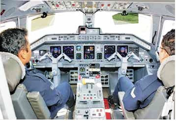

AEW&C Cockpit
AEW&C Control Room
Operator Workstation

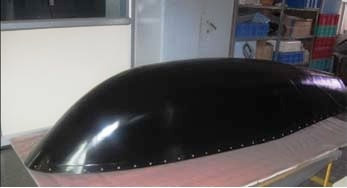

SATCOM Radome for AEW&C
Satellite Communication (SATCOM) is one of the sub-systems of AEW&C system and is mounted on the top of fuselage of the aircraft.
A radome protects the antenna from environmental effects in addition to transmit and receive electromagnetic radiations. This radome has been designed and developed by CABS and manufactured by a private partner. Radome meets MIL-R-7705B specifications. Electro-magnetic (EM) design of the radomes meets Ku band (for SATCOM) frequency 10.7 to 14.5 GHz radiation requirements. The radome is designed to withstand aerodynamic loads with minimum deflection under critical aerodynamic loading conditions. It is qualified for lightning protection as per MIL-STD-1757A and also meets bird strike requirements as per FAR 25.571 (e) (1).
The size of SATCOM radome is 2702 mm x 703 mm x 563mm which is, as of now, one of largest GFRP radomes developed indigenously. The weight of the radome is about 20 kg.
Aluminium alloy AA6061T6 strips are bonded in a specific pattern on the radome surface for lightning protection. Radome is also protected with special radome paint.
Satcom radome

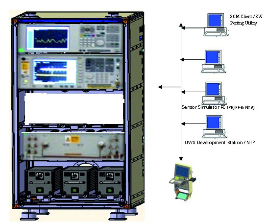

System Test Integration Rig
AEW&C System being a System of Systems poses greater challenges in integration, This gets even more challenging when these systems have to work in tandem to form an integrated system. The complexity increases when the same is to function in an airborne environment where there are constraints in terms of volume, power, cooling etc.
The System Test and Integration (STIR) facility ensures a smooth integration and necessary clearances from the stakeholders before being put on the aircraft to reduce both the time and costly flight testing of the systems.
This facility is equipped with simulators for checking the system for mechanical, electrical, digital, RF and software integration and providing an integrated environment for tandem working of the system. The Rig also facilitates in terms of carrying out the behavior of the systems under various scenarios and environment that the mission is likely to encounter and caters for the stress testing of the system

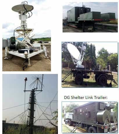

Ground Exploitation Station
The Ground Exploitation Station is a transportable field deployable system, which can receive the information from AEW&C system both through a LOS and Satellite Data Links. The GES can be located in remote locations, thereby enabling the availability of the air situation picture around them in real time.
The Ground Exploitation Station (GES) acts as an interface between the AEW&C and the IACCS. The real-time Recognizable Air Situation Picture (RASP) generated onboard AEW&C is transmitted to the GES, which is, interfaced with the IACCS through an interface unit for dissemination of tactical information to the decision makers on the ground. Similarly, the command from the IACCS to the AEW&C is routed through GES.
GES enables the officers to see live sensor data collected by the onboard AEW&C sensors. All this visualization happens on ground (in GES)/Mission Control Room (in IACCS room).

GES Operator shelter: - houses all the indoor LRUs of mission system. It has been designed to accommodate four racks (for fitment of LRUs, UPS and batteries), two operator work station consoles, one CCTV console and a power distribution panel. Racks are fitted with various mission system LRUs like system controller, base band units, tracking receivers, antenna control unit, radios, high power amplifiers, VAIU etc.
C Band Data Link Trailer: - is fitted with a 1.8 meter dish antenna; with two feed (Main feed & Acquisition Aid Antenna). The antenna is fitted on a scissors lift; the scissors lift aids in the operation of the antenna at an elevated level.
The CBDL trailer also houses a drive control unit, a RF system, a dehydrator and a scissors lift motor.
Ku Band Data link trailer: - is fitted with a 2.4 meter dish antenna with its offset feed. The KBDL trailer houses a RF system consisting of Block Up Converter (BUC), Low Noise Block Down Converter (LNBC), and Electronic Compass. Four hydraulic jacks are provided for the trailers, which aids in meeting pointing accuracy of ground KBDL antenna towards satellite. VUHF Masts has two 18 meter masts fitted near the shelter. VUHF antennas are fitted on top of these two masts, which help in attaining maximum range for communication.

The purpose of the ATE is to provide the simulating input to the LRUs and measuring the response based on which decision can be made, whether LRU can be declared as OK or not. The testing of the faulty LRUs off loaded from the Mission System is also done in ATE. It also carries out tests on spare LRUs to the required level of confidence prior to mounting into the Mission System. The ATE comprises modular and standard commercially-off-the-shelf test equipment interconnected through PXI/PXIe/GPIB bus and also through a fully managed Ethernet Switch.
Excitation and measurement is done by the test equipment in the ATE through ITA. The ATE software is built on industry standard platform- NI LabVIEW and NI Test Stand.
Principal elements of the Airborne Radar Test Bed

Netra Mk 2 will use GaN based TRMs, and will have more than twice the range of Netra Mk 1. Given that A320 is a bigger platform than ERJ 145, DRDO can use bigger radar package with more transmit receive modules(TRM).
The new AAAU will have a weight of approximately 3 tonnes and dimensions of 9m x 1.2m x 0.9m which is nearly double than that of the Netra Mk-1 AAAU
According to CABS 1st Netra Mk 2 will start to be handed over to IAF by 2028.
Netra mk2 will cover 300°, The radar configuration will have Two active antenna array unit (AAAU) assembled back-to-back and mounted on top of the fuselage with an additional nose mounted Radar unit.
Netra Mk2 will be able to detect low observable platforms from long distances, and will be able to perform better in intense EW environment.

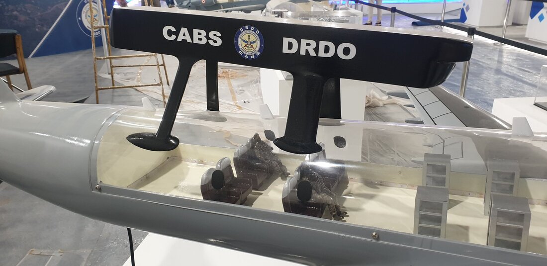

Netra Mk-2 model at Aero India 2021
Possible Radar Antenna of NETRA MK2
