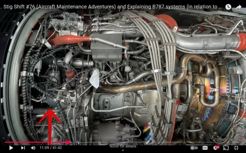

View: https://www.youtube.com/watch?v=-MDjRMkc-cc
OBSERVATIONs in video-

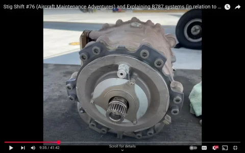

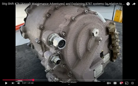

- Each engine has 2x generators giving total 2x235 KV power, connected via gear box to spool.
- Generators are oil cooled.
- Generators have extra PMG (Permanent Magnet Generator) powering the GCU. PMG is not PMA. so the Generators power their own brain (GCU).
- EEC is dual channel redundant.
- As i said earlier, EEC gets powered from its PMA.
- If PMA fails the A/c's 115 AC bus kicks in.

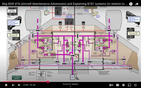

- If 6 fuel pumps (2Left + 2 center + 2 right) pushing fuel fail, then engines have their own suction pump.
- If fuel filters are clogged then bypass will happen (warning displayed on MFD).
- Fuel tanks have water scavenge pumps, water being heavier sits down.
- Engines would stutter with smoke if fuel contaminated.

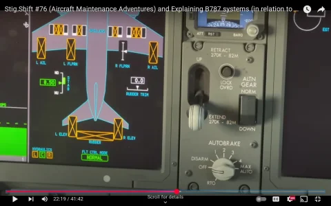

- Gear handle in cockpit tells gear to tilt forward, door open, then retract.
- 787-8/9/10 have different sequences of gear retraction.

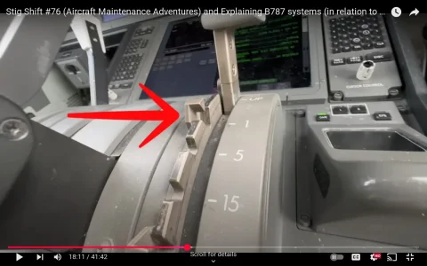

- Flaps handle well separated from gear handle.
- All controls are made with different size, texture, shape so that if cockpit has smoke then pilots can still operate them well.
- The flaps positions have notches & detent to prevent accidental flaps decrease. Such pilot error is already being debunked in AI-171 case.
- Auto-gap function, keeps the slats deployed for lift, no manual control needed. Even if flaps retracted the slats might stay deployed for some time until sufficient speed. Also depends on AoA.
- Pre-gap function when below 225 knots. Operates same like auto-gap but operates when there is some kind of failure.
- Load relief function - auto retracts flaps when speed increases & flaps cause excess drag.

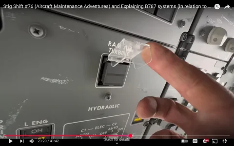

- RAT auto-deploys in following conditions -
- loss of all engines​
- both engines are less than idle rpm​
- loss of all hydraullic power​
- loss of all electrical power​
- loss of BPCU (Bus Power Control Unit), which detects lost power of C1 & c2 TRU (Transformer Rectifier Unit).​
- On approach - loss of all 4 EM (Electric Motor Pumps), hydraullic pressure & loss of either left/right Flight Control ACE (Actuator Control electronics)​
- Rotor burst on take-off causing loss of both PECS (Power Electronics Cooling Systems)​
RAT can be manually deployed by button on overhead Hydraullic panel.
DERIVATIONS (not conclusion) from OBSERVATIONS -
- As RAT can auto-deploy when engines below idle RPM, an EEC glitch detecting high EGT for long could reduce thrust by reducing fuel flow. Although such glitch is very difficult to imagine.
- EEC is dual channel, has PMA. So if 4x generators lost, the PMA keeps EEC powered & connected to FMC.
- 4x GCUs have their PMG so 1 GU fail on each side is also tough to imagne. So all 4x generators can't be lost together.
- Due to water scavenge pumps, fuel contamination with water should stutter the engine with smoke, perhaps while taxi itself, but not stall the engines towards crash.
- Flaps can be auto-retracted by FMC by load relief' function. I wonder if a glitch can occur here or in auto-gap, pre-gap functions. But this doesn't seem to be case in AI-171 case.

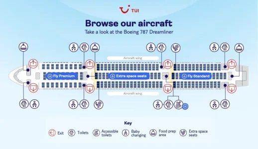

Again a racist tinge to blame Indians only. First it was pilots, now its passengers, Air crew and eating habits. Seems like coordinated dispersal of fog and confusion.
IDK if historically such leak happened.

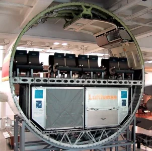

The toilets, galleys are near the equipment & avionics bays.
Jets face bad weather, turbulence often which can cause spilling of food & liquid. Hence floor & partitions are suposed to be constructed strongly.
May be there are 2 layers of metal/composite b/w passenger deck & lower deck, passenger floor + lower deck ceiling, which will make leak difficult.
But It'll backfire upon them bcoz this was not so old jet that the floor will crack & go unchecked.
If such thing happened then it means bad manufacting actually, what Boeing whistle blowers exposed & testified.
