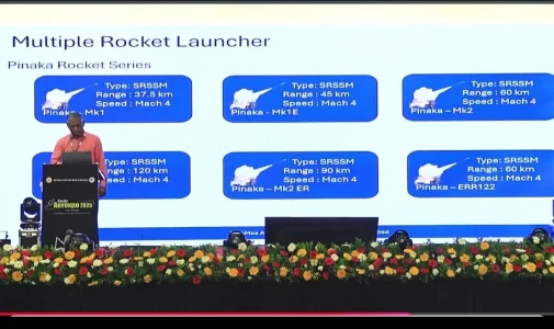

Few people talked about how RBU 6000 can also be used to do shore bombardment. But Navy is looking into Naval Pinaka which may replace that role also. Even an Guided Pinaka with 75KM range will be devasting for enemies.
