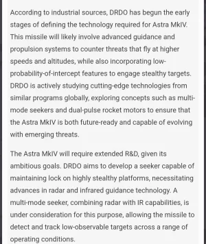

If this news is is true, then good news, work for a 3 pulse solid rocket motor astra mk4 missile has started.
So it seems astra mk3 is intended for mainly awacs killer role in long(250-300+km) range and secondary role against fighter jets( at 130-160km range for good kill probability).
Higher speed and high altitude =fighter jets.
( rocket motor will help in this role due to high maneuverability and also range that 3 pulses and bigger size of missile with provide)
With targeting system designed to me more effective against stealth jets compared to traditional targeting systems used in current missiles.

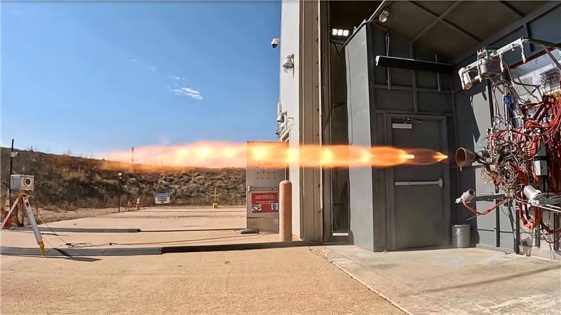

"This will be a storable liquid rocket engine capable of hypersonic speeds in atmosphere or exoatmospheric, and nothing else like it exists on that basis.”
( kh22 exists for more than 40+years, new kh 32 exist, both are liquid rocket powered cruise missiles, though not hypersonic, kh22 and kh32 are high supersonic in midcourse(mach4+)
also https://testpilot.ru/en/rossiya-e/mikoyan/kh22/ ).
"Rockets come in two different types, either solid or liquid. Solid rockets consist of a pre-mixed propellant and oxidizer to enable combustion, but cannot be controlled (or “throttled”) once ignited. Liquid rockets use separate liquid fuel and oxidizer that are combined and burned in a combustion chamber, enabling a rocket to be throttled as a result. Liquid rocket fuel is also more hazardous to store than its solid counterpart and must be kept at cryogenic temperatures, but tends to have better performance.
Ursa Major is aiming to close the gap between solid and liquid rockets through the Draper, providing the tactical storage capabilities typical for a solid rocket motor and the throttle and greater ranges offered by a liquid, with a key enabling feature being a storable combination of hydrogen peroxide and kerosene as propellant. Draper itself was developed with a mix of Air Force and internal funding and is based on the company’s Hadley engine, which has flown three times, according to Jablonsky. "
"Jablonsky said over 80 percent of the engine is 3D printed and comes with a modular design. With 4,000 pounds of thrust, the Draper will initially be a hypersonic missile configuration, which Jablonsky said could be sea-, land- or air-launched and even stored in space for several years in a space-based interceptor — a callout to President Donald Trump’s “Golden Dome” initiative. Ursa Major is targeting the commercial market as well, Jablonsky said, pointing to applications like space mobility. "
( so similar to the anti ballistic varient of LR-ASHM we are developing 1000011014.webpbut liquid fuel instead of solid fuel that we use.).
The breakthrough here they are talking about is making liquid fuel similarly efficient as solid fuel, but still having throttle control that liquid fuel provides, but solid fuel doesn't.

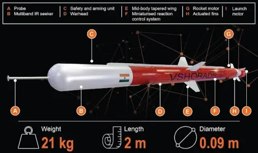

Not to put any doomerism here but IA is again at its damn stupid QRs in this RFP
Length of missile should not beore than 1.85m including launch tube. Drdo Vshorads is more than 2m itself.
Weight of whole system in single launcher config should not beore than 28kgs. This excludes every kind of tripod manpads system from the list including our own Drdo Vshorads.
So, unless Drdo has made and tested it's shoulder fired MPDMS, the tripod Vshorads doesn't fit in requirement.
Most likely, this is a yet another emergency purchase of most likely igla s under the disguise of Indigenisation by Adani which is actually just screwdrivergiri.
