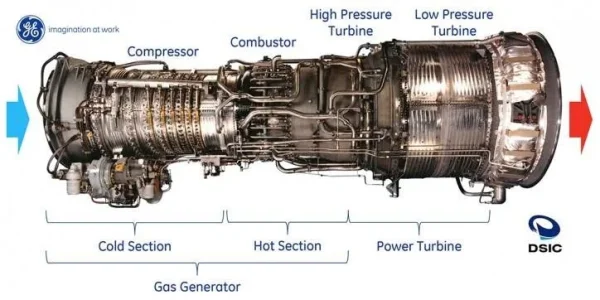

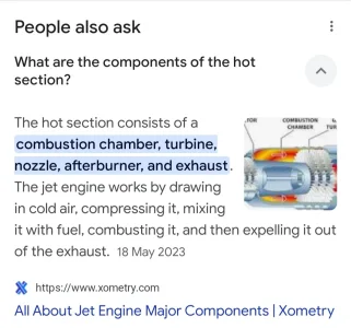

Hot section refers to the combustor, HP and LP turbines. Afterburner is a part of the exhaust system, not the hot core section.
Both are part of hot section, combustion module comes before Turbine inlet but the energy is generated in Turbine inlet only… so basically the core of engine , we have major gap in Turbine inlet not other modules …
No. Afterburner is not a part of hot section. It's not even a part of the engine core. As I said, it's a part of the exhaust system.

No, the turbine inlet and the afterburning section are not the same. They are two separate and distinct sections of a military jet engine, with different locations and functions.
,The turbine inlet is located before the turbine and immediately after the main combustion chamber.
Its purpose is to channel the hot, high-pressure gas produced in the combustor into the turbine blades. The flow of this gas is what spins the turbine, which in turn powers the compressor at the front of the engine.
After-burning Section is a component of the exhaust section, located after the turbine and before the final exhaust nozzle.
Its function is to provide a temporary, significant increase in thrust (often called "reheat"). It works by injecting a large amount of fuel directly into the hot, oxygen-rich exhaust gases that have already passed through the turbine. This reignites the gases, causing them to expand even more rapidly and exit the nozzle at a much higher velocity. This process is highly fuel-inefficient and is typically used for short periods, such as during takeoff, combat maneuvers, or supersonic flight.
Simple Analogy
Think of the engine's main components in a line:
Intake → Compressor → Combustor → Turbine Inlet → Turbine → Afterburner → Nozzle
As you can see from the flow path, the turbine inlet feeds the turbine, while the afterburner comes much later in the sequence to boost the exhaust gases.

Yes, the turbine section is a part of the hot section. It comes right after the combustor section. As you said, GTRE is having issues in both the combustor (hot section), which has been fixed in KDE and afterburner (on which Brahmos aerospace is working).

Look, I don't need a "explain like I'm 5" lesson of the Brayton cycle from you. I stand by what I said that afterburner/reheat is not a part of the hot core section.
