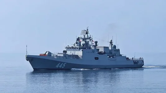

@Binayak95 how good are the Fregat Radars in comparison to their Western contemporaries?
Its a mechanical steered array. That is its biggest weakness. Rest toh software ka khel hai. near 250 km detection range for a fighter sized aircraft (not VLO), some ability to detect low altitude skimming missiles at about 20, 22 km range.
Depends entirely on the missile. Brahmos, sure - its RCS is quite big, SCALP - no chance in hell.
Good enough tracking and weapons envelope to engage flying target drones by the main gun.
