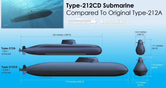

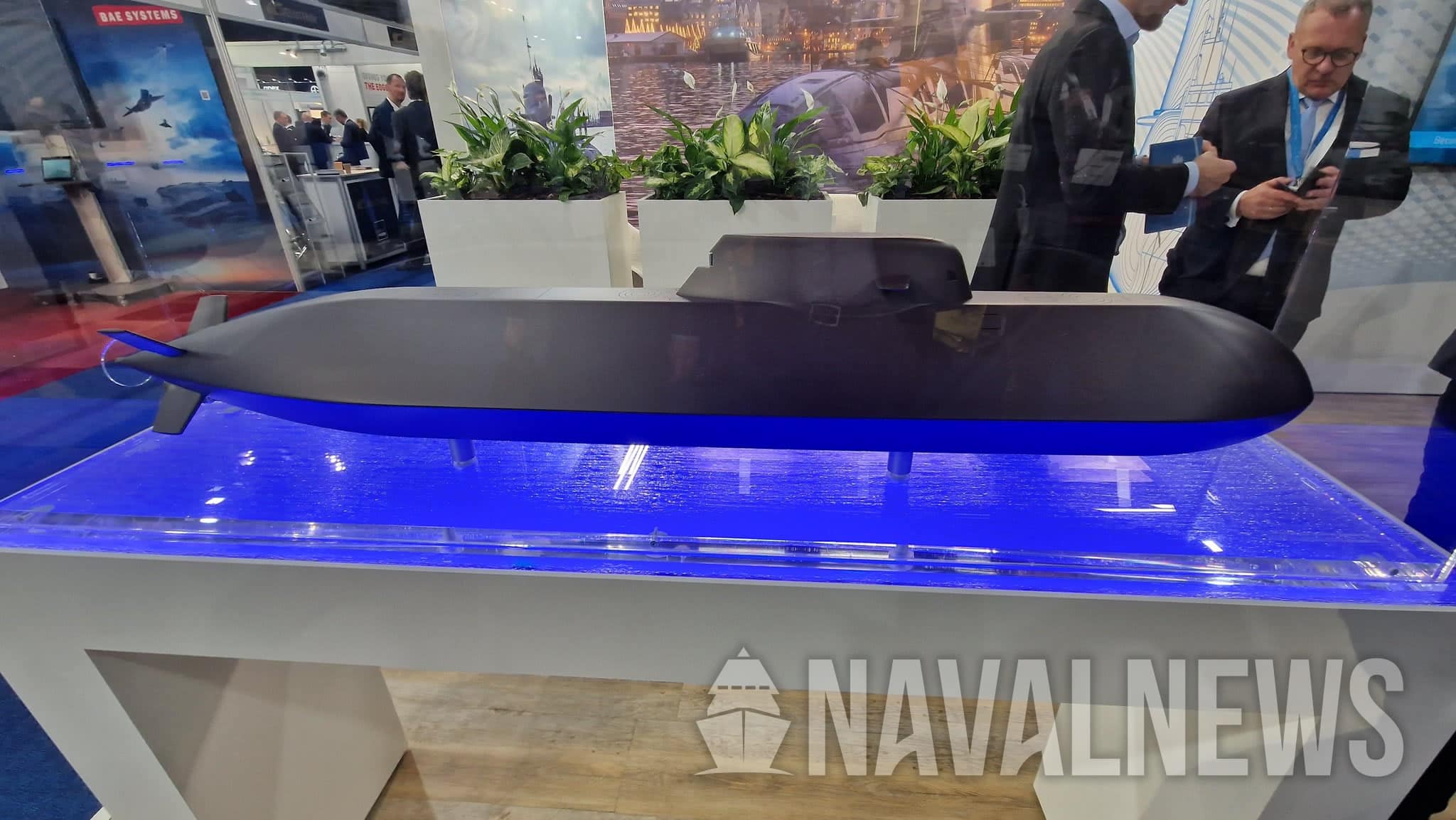

If India is going German for P75I then I hope it is Type-212CD. With this India can absorb the active sonar stealth shaping technology.
That angular "stealth shaping" has kinda dubious benifits.
Unlike EM waves in air, Sound waves does definitely does not travel in straight lines underwater, and it's hard to predict exactly their trajectory. So most "tricks" used in RCS reduction won't work. -The sharp edges used in RCS reduction are all but hydrodynamic. In worst case You'll end up making a lot of water noises, easily detected at long range by passive sonar.
You would want to design the hull in such a way that it doesn't produce much sound when moving through water, a hydrodynamically compatible hull, sharp angluar Features are kinda opposite of that.
But again, tkms must have thought about it, bit I still doubt it's benifits.
Type 212CD with it's goodies isn't coming
We will get a cutdown export version.
Admirols still will be happy since they finally get AIP tho.
For e.g Type 212A had a non magnetic hull, but Germs wouldn't sell this to non-Euro jamaatis.
Type 214 was the export edition with a normal hull.
imo Admirals must get a normal shaped submarine for the 6 P75I subs order
They can place another order for 6 with angular hull shaping.
Aside from questionable benefits since this is a new design there's bound to be teething problems, better go for a proven design only.

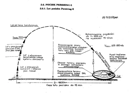

DF-21 missiles are based on Pershing 2. Pershing 2 at 15 km altitude when it starts using radar seeker has a minimum terminal speed of 600-650 m/s (1.75-1.89 mach). I think the estimate of terminal speed of Pershing 2 is in the range of 1.75 - 3 mach.

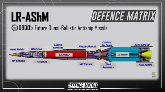

Also our LR-ASHM does have a seeker and has minimum speed of Mach 6+ in terminal.

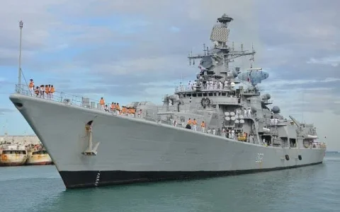

Indian destroyer fleet
india hv/will hv near 13 destroyers.

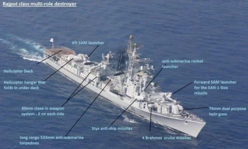

1:- rajput class = india hv currently 3 remaining rajput class ships in operation. two are already retired. these ships commissioned in indian navy from 1982 to 1987. they r very near of their retirement. these ships is near 5000 tons displacement.
2:- delhi class = we made total 3 this type of ships. these comissioned in indian navy from 1997 to 2001. these are 6200 ton displacement ships. it need modification.

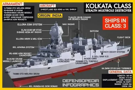

3:- Kolkata class = we made 3 of these. these commissioned in indian navy near 2014 to 2016. these ships are 7500 tons in displacement.
4:- vishakhapatnam class = we made 4 of these ships. they r with little improvement over Kolkata class. they commissioned in indian navy from 2021 to 2025. last ship will be commission in 2025. these are 7600 ton displacement.
we hv plan to induct 6-8 project 18 class destroyers. but they r in drawing board. they r in cruiser class, not in destroyer class. we r expecting them to commission in 2035-40 period.
so untill then, we will operating 10 destroyers. i think we should buy 2-3 more improved vishakhapatnam class. so our manforce nd facility dont sit idle. i know we r making near destroyer size frigate (nilgiri class) in 7+8 (upcoming) = 15 numbers. but still both hv capabilities difference.

For example our lrashm is kinda like fire and forget missile. it only needs initial coordinates of the target ship as a bare minimum, it will reach it within few minutes, and at the speed ships move deviation in position will be small at most 5-10km well within seeker capability of LR-ASHM.

Then the widely quoted mach 10 terminal velocity can't be true. The velocity in <15km altitude zone has be less than mach 5 to use the RF or IR seeker, otherwise plasma sheath is going to make them dud.
Pershing 2 velocity in this altitude zone was in range of 1.75-3 mach. It's RV didn't have any solid motor. Does DF-21D have a solid sustainer motor in it's RV otherwise it's terminal velocity is going to be less than mach 4.5 (actually more close to Pershing 2).
