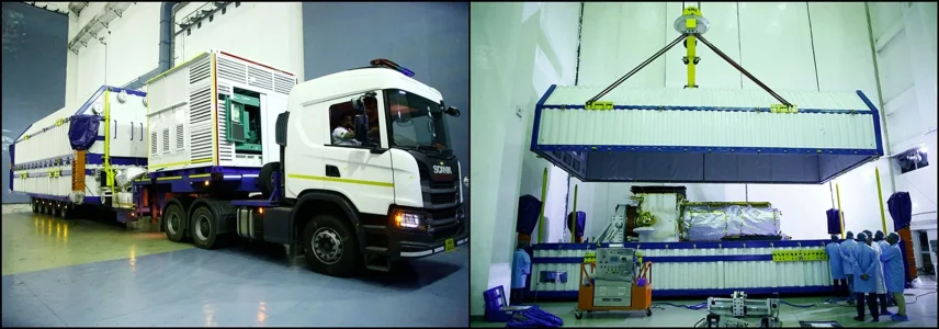

The addition of a reflective coating on the spacecraft's large deployable antenna delayed the launch of NISAR. Credit: NASA

NISAR was previously scheduled to launch in the spring of this year, but NASA announced in March that it would delay the launch to make repairs to the spacecraft’s 12-meter deployable reflector used by its main radar instrument. Engineers concluded that the reflector would get warmer than expected when in orbit immediately after launch while still stowed. Those repairs required shipping the antenna from India to California.
NASA completed those repairs by October, shipping the antenna back to India on a C-130 aircraft. The agency said then that NISAR would launch in early 2025 but was not more specific. NASA had said in July that the launch could not take place between October 2024 and February 2025 because the launch would place the spacecraft into an orbit with “periods of alternating sunlight and shadows” that would create temperature fluctuations affecting the reflector’s deployment.
Bawden said the issue with the antenna was discovered during tests of the spacecraft in a thermal vacuum chamber. “Some of the temperatures were higher than we expected them to be,” he said, “so what we decided to do is remove the reflector from NISAR and bring it back to the United States.”
The fix to the reflector, he said, involved placing strips of reflective tape on rods in the reflector that were black. “We are set now with NISAR,” he said. “The hardware is completely checked out.”
