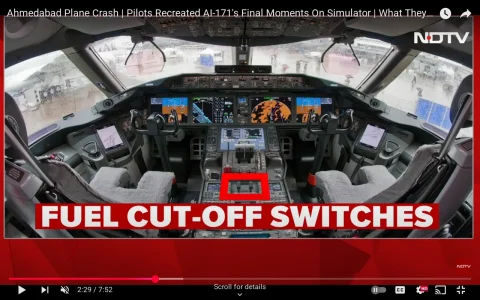

These veteran defence journalists talking about fuel switches pointed to the engine fire handles on international level news.
:doh::facepalm2::facepalm4::boink::boxing:
These people are part of top big media houses, with good salary.
The media houses gave big fee for their ride in jet fighters.
Still they can't do simple google & YT search also.:smash: In schools there is Internet search competition.
This is the quality of reporting we have.

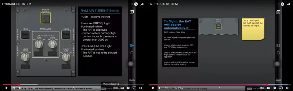

RAT was manually, proactively deployed.
In flight they had chance to use APU also.

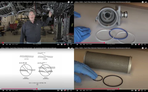

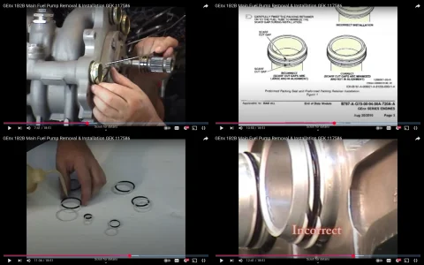

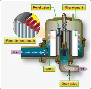

I checked some YT videos of fuel filter & pump in GenX-1B engine & found that there are multiple rings for sealing joints, just like in our kitchen pressure cooker.
I wonder if a reaction can take place here.
View: https://www.youtube.com/watch?v=NOTM93cjfGM
View: https://www.youtube.com/watch?v=BL2LRvtwp9o

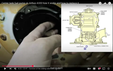

I couldn't find pic/vid of 787 fuel tank fuel pump. Perhaps it might little bigger but identical to this one i found - of A320.
