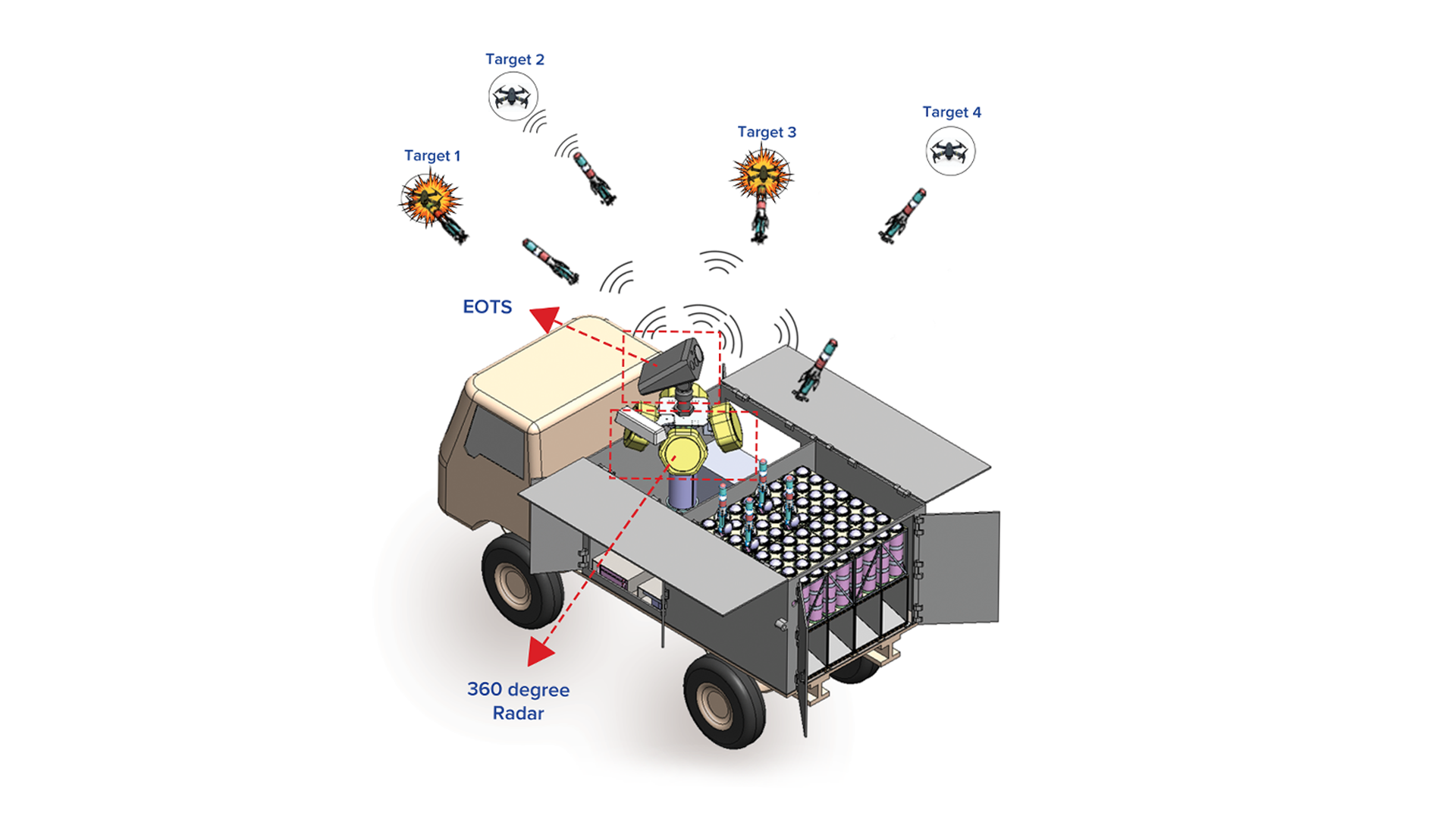

India has tested its first indigenous micro-missile system designed to take on the threat of swarm drones. Two firings were carried out successfully at Gopalpur Seaward Firing Ranges this week.
Being developed for the Army, the multi-layered system hit designated virtual targets at over 2.5 km, showcasing a unique low-cost option to take on large-scale drone attacks that have become a persistent threat.
The system can simultaneously fire more than 64 micro missiles. Being developed by Economic Explosives Ltd, the system will be mounted on a mobile platform for quick deployment to a threat zone. It is designed to operate in all terrains, including high-altitude areas, to meet specific requirements of the armed forces.
