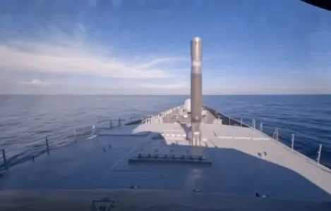

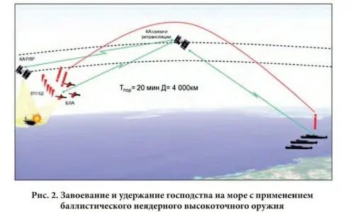

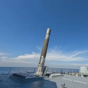

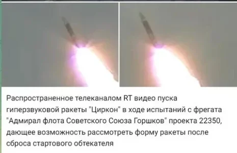

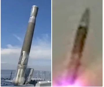

Na, I'm saying it based on talks I had with a Russian junior engineer working for russian mod on a forum.
Allegedly, these first two are flight trajectories of zircon missile he shared, a depressed hcm like trajectory with ~1000km range, a mix of ballistic+ cruise for more range, and quasi ballistic trajectory for even more range(~4000km)
And in these later pics, it was taken from a Russian new channel which was present to see and record the launching of zircon

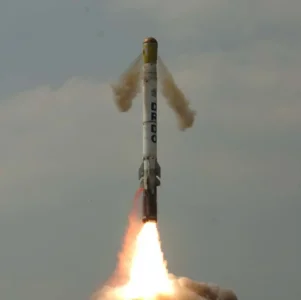

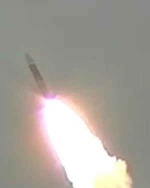

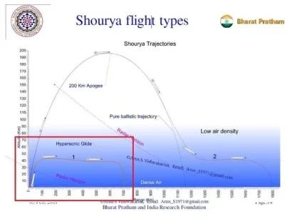

As a bonus here's shaurya missile compared to zircon.
Shaurya also has a depressed hcm like trajectory with max range of ~800km, and quasi ballistic trajectory with higher range.

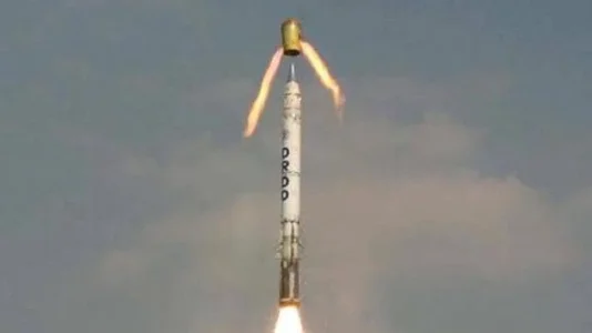

Well large part of my believing zircon to be rocket sustained is based on this Indian missile that called "Shaurya" as mentioned before.
'Shourya'_missile_test_fired_on_November_12,_2008.jpg_e87e906a-07a4-11eb-adc0-f7cc04e39ce3.jpeg
Length~10m, width~0.74m, weight 6+tons.
Uses solid fuel, two stage missile.

Shaurya is a Q-BM much different from HGV or HCM.
It has a quasi ballistic trajectory where is goes at hypersonic speed at the heights lower than 50 Km IIRC and we don't know about the ability to maneuver while going in the depressed trajectory that's why it's not classified as Hypersonic missile.
I remember reading somewhere about Shaurya managed heat during Hypersonic flight and it was different from how HCMs worked around heat and plasma formation during flight something along the lines of heat distribution along the entire body or rotation I don't remember exactly.
Don't know about Zircon being a Q-BM though.
HCM are hyped due to
1, hypersonic speed.
2, fly at 20-50km at atmosphere, so later detection than ballistic missiles many that leave the atmosphere.
3, fly in a depressed/straight and unpredictable path, instead of any form of ballistic/parabolic trajectory.
These things are what make the interception of HCM so difficult and hype them up so much.
Shaurya fulfills all three points I made.
So shaurya is not a quasi "ballistic" missile in depressed trajectory mode, because in this mode it doesn't fly in ballistic trajectory at all, it's flight trajectory looks most similar to flight trajectory of HCM.
Though Method of propulsion, way of cooling is different than what we associate with traditional HCM.
While HCM's have become synonymous with scramjet tech, but ultimately its a method of propulsion, If you can use another method of propulsion( rocket powered) to achieve similar flight trajectory at similar altitude at hypersonic speed then it's a HCM, albit rocket propulsion is lot less efficient than airbreathing scramjet, hence lot more fuel needed hence increase in weight.
Though there are other benifits, like bigger warhead, maneuverability not limited by needing to maintain stable airflow to scramjet/ramjet etc, ability to use different flight trajectory( depressed like hcm, mix of both, quasi ballistic), lot cheaper and less technologically complex to make.
Ultimately the HC in HCM, hypersonic cruise Is about cruising at hypersonic speeds, not about what propulsion method is used to cruise at hypersonic speeds.

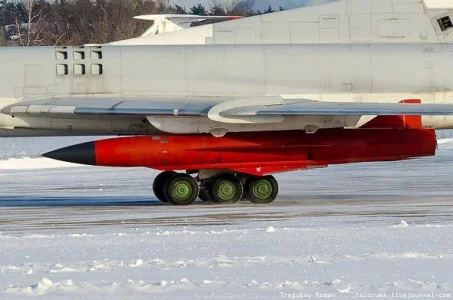

For example, Russia has kh32 higher supersonic/near hypersonic( maz speed mach4.6) air launched "cruise" missile, and it's ",rocket powered".
