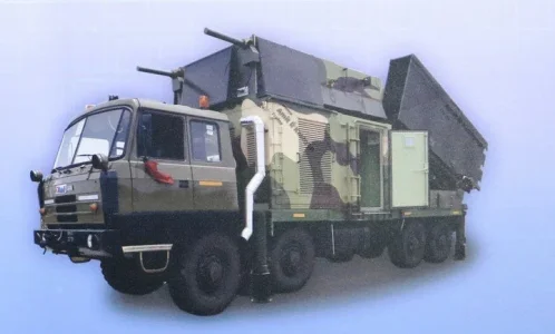

Another concept that I see potential of based on recent skirmish is of mobile independent SAM units of 80-100km range, something like QRSAM or Akash-NG (first mobile launcher) which can be dispersed close to the border 20-25 km depth (plain area) and fire at very short notice.
Emission wise they remain silent and are interlinked with ASP network and take target of opportunities. If they need to provide target updates until SAM goes pitbull, that would be less than 5 minute of vulnerability. Ideally, these SAMs should be able to receive target updates from other fire control radar further behind, then there is minimal vulnerability.
This will give less reaction time to PAF and push them further deep into their territory, it will threaten them from unexpected direction.
Also, could play a role in managing stealth threats if they come close or cross border. Let's say if VHF radar detects J35 then mobile SAM unit can emit it's fire control radar and being so close to it might actually be able to track it and fire SAM at it.
I thought that WAS the standard practice!!
I meant something like below, that has minimal footprint and doesn't need to be deployed all the time. It can be mobile along highways close to the border or be under shelter and when it has a target of opportunity it gets ready to fire within 1-2 minutes.
Basically QRSAM but longer range and something that is not deployed as battery but more independently across a wider front.
