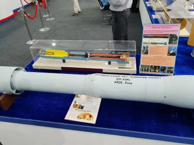

Re RBU-6000, I can see why IN needs it on many of it's warships, India's western seaboard is pretty shallow which favors submarines. But I don't get the need for all capital ships with > 6000 tonnes to be equipped with 2 RBU-6000 system with reload mechanism which takes up valuable real estate, would rather have more VLS for missiles.
DRDO came up with ERASR which increases range to 8900m. But does this support the homing head type of feature like 90R does? RBU-6000 90R has a seeker range of 130m and can maneuver a bit.
The 90R has a range between 600 m and 4.3 km, and a depth of up to one km. The range of its acoustic homing head is 130 m. The 90R1 is believed to feature improved range, although these have yet to be revealed in open sources. In any case, Tuchkov noted that "it can be assumed that designers did not increase its depth characteristics, since 1,000 m is beyond the limits of any NATO submarine or torpedo."

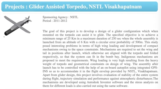

LWT missile (with glider) similar to RUM-139 is achievable by DRDO.

so the RBU 6000 is not technically what we have onboard our warships. its IRL. L&T has retained the basic shape of the RBU launcher, but the reloading mechanism, and targeting machinery is no longer electro-hydraulic. Its entirely electric.
its smaller, lighter, less deck penetration and lesser maintenance intensive.
As to why we still have it -
its a great final defence against incoming torpedoes, against divers and works great against swarming USVs.
And further its far cheaper to fire off a full salvo of 24 rockets than even one ASROC or any VLS'd solution to the above problems.

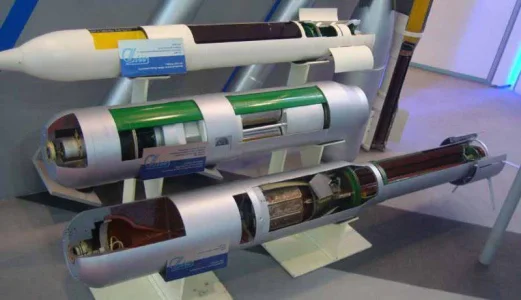

Regarding protection from torpedo, something like this can be looked at:
