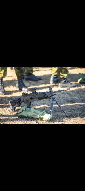

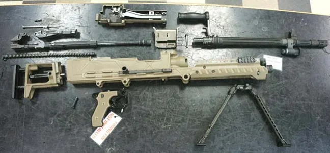

Is it just me or negev seems to lack rail space. Estonian Negev
Yeah you can't really use any long sight, it will be impossible to reload unless thety use a realy high riser like they use for ofb mag

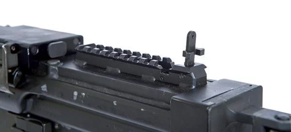

it's not just you, it's truth, because on Negev they chose to put that iron sights of removable type here straight atop the limited top rail, as that front cover is opened for feeding the ammo and not that ideal for further rails for optics
but once you remove it, you do get some acceptable length top rail like this, also has a fixed aperture flip-up backup iron sight integrated to it kinda like tavors and X-95
so yeah you can't multiply optics but some regular ACOG like thing can go atop it just fine
Overall negev lacks rail space in comparison to other mg counterpart but match them in performance
can they extend the rails with some upgrade or something to accommodate bigger or longer optics like lpvo

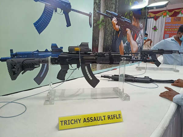

@Unknowncommando @johny_baba Whatever happened to this little guy TriCa. Did it see any success yet anywhere in India?
View: https://www.youtube.com/watch?v=i7IJhZhmjog
Didn't the NSG order 100 units?
https://timesofindia.indiatimes.com...tory has five new,and development (R&D) stage.
AK 203(IN) vs Trichy Assault Rifle (FAB kit)
Vs

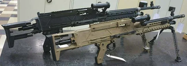

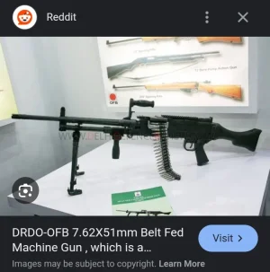

well we can just induct some good numbers of DRDO 7.62mm Belt Fed LMGs instead of tinkering around with Negev NG-7 design which IPRs are not in our hands anyways
it has longer enough top rails to mount any LPVO, and at 9.5 Kg of weight it's in M60 range, and although it's seen as lighter machined receiver build of MAG 58 we can still attempt at modernising it like giving it a tactical buttstock and handguards near gas tube, a better bipod etc to make it more appealing as an LMG-ish thing

Estonian Negev with extended rail

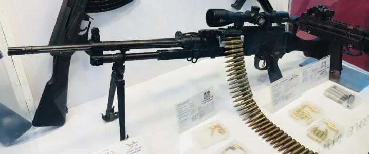

It is mag 58 compare fn mag 58 and drdo lmg and find the difference
This one is drdo one

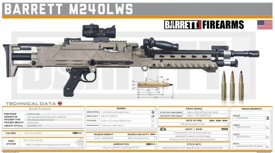

I am once again BEGGING OFB wallas to take a look at Barrett's M240 LWS. I also don't get why every gun needs an FNC style pistol grip as if more ergonomic alternatives don't exist, despite reaching into FAB's parts bin for years now.​
well it's some rail attachment on Negev NG-7 that goes over standard top rail and extended upto full length of receiver and affixed with hinged top feed cover at front, so when you open feed cover it also hinges up
not a bad setup per se, but it's something that aftermarket parts makers can easily make here @Baseplate @BlackViking sorry kinda forgot who was into making FAB style stuff here but there's an opportunity here for Negev NG-7

comparing it to DRDO / ARDE / OFB whatever 7.62 NATO belt fed 'LMG' here
> based on MAG 58 that is around ~12 kg
> barrel seems shortened a bit from ~24.5 inches to 20 inches some, also detachable with handle
> gas regulator is also simplified a bit
> receiver is of milled type now than heavy riveted build on MAG 58 comprised of thick metal plates, now lighter - it's straight taken from Barrett M240 LWS BUT barrel length here is longer
> now it has full length top rail on feed cover
> MAG 58 style vertical tilting downward locking bolt and long stroke gas piston bolt carrier system
> now comes with semi-automatic and fully automatic fire modes
> weight ~9.5 kg
so for around same barrel length of Negev NG-7 you get uber reliable GPMG-ish 'LMG' on this one with milled receiver, of course it goes about 2 kilos up due to things i mentioned,
BUT it's totally possible to reduce the weight further by putting titanium alloys in construction of BCG and milled receiver and related parts inside, and additional modifications here and there => there exists M240L which has 21-some inch barrel at around 9.3 kg with titanium receiver alone
DRDO ARDE OFB AWEIL whatever guys shouldn't have stopped with just putting a new milled receiver and worked further to shed some weight, if they are able to achieve even 8 Kg of weight it'll be on par with Negev NG-7 but far more sturdier and reliable
right now this 'LMG' is standing at M60 vietnam era design, which was stamped receiver, rotating bolt design with a heavy short stroke gas piston system and yet weighing ~10.5 kg 🤷‍♂️, there's lots of work to be done
