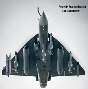

Edited pic to show an A2A maxxxing loadout on tejas
btw are these fuel tanks necessary for it?
Fuel maxing is a good to have feature. Airforces around the world avoid it on AC with sleak wings having high wing loading like F16 , J17 blunder (non-fiber composite airframe bonus) etc. But you must have seen in pictures how Mirages or Rafale doesn't shy away from carrying drop tanks, they are like permanently attached. Similar delta wings help LCA to achieve quite low wing loading, it helps to maintain airframe life despite missile and Droptank maxing. Extra fuel also comes handy to compensate drag generated due to delta wing.
Yeah because babus at HAL and MoD even after so many years didn't come across the idea of conformal fuel tanks as an airframe design upgrade after Mk-1A, not even in Mk-2.
When I asked HVT sir about CFTs and dorsal hump like mig-29 for Tejas few years ago he said Tejas is good in its current state.
Maybe the idea is CFTs and Dorsal hump will have aerodynamic penalty that aren't worth it.
IG idea is Tejas won't be doing interception with drop tanks on.
IMO they could go for conformal weapon bays like the F-15 SE which could help with RCS and also enable them to have more A2A weapons at the same time.
Just a question... can the ASRAAM missile on the right can be shifted on lower side increasing space for middle pylon to carry 2 missile
Something like this without the left side bomb.
best sensor combo lol, jai ho gang is another level. mf cannot go to combat without pods. it doesnt even have a maws. be real, it can atmost take on jf17 and block 30 or block 50 f16 along with some old chini aircraft on eastern front.
but a much needed filler for squadron strength till we get mk2 and amca
I'm sorry to say this but this is by far the worst possible dual pylon arrangement you can have. With a missile like ASRAAM, so clean and with hardly any fins - you can really pack them tight. Did HAL or ADA design this?
It just wreaks of a lack of confidence to try out more efficient and effective dual racks because you are scared of aerodynamic integration which in turn means you are just not confident in your ability in aerodynamics - even with such a simple and clean missile like ASRAAM.
I can literally hear the thoughts of the intern who designed this "Just keep the missiles as far apart as possible, so I don't have to work on aerodynamic interaction. Oh no! this now eats into the next pylon and almost eliminated changes on the next pylon - oh fuck it at least this way I can show something and won't have to deal with the aerodynamic interaction. We will deal with the problem later when users ask for more weapons on the primary pylons - somebody else's problem".
This seems like HAL to me, since I have plenty of colleagues who deal with HAL and can attest to their incompetence (folks working at MBDA, Martin Baker, BAE etc.) - I have usually pushed back on them but after seeing this there is little doubt.
I'm sorry to say this but this is by far the worst possible dual pylon arrangement you can have. Did HAL or ADA design this? It just wreaks of a lack of confidence to try out more efficient and effective dual racks because you are scared of aerodynamic integration which in turn means you are just not confident in your ability in aerodynamics. Missile integration and pylon design is serious business and the aerodynamic studies are as involved as those of entire aircraft.
I'm sorry but I would not think twice before firing whoever is responsible for this.
