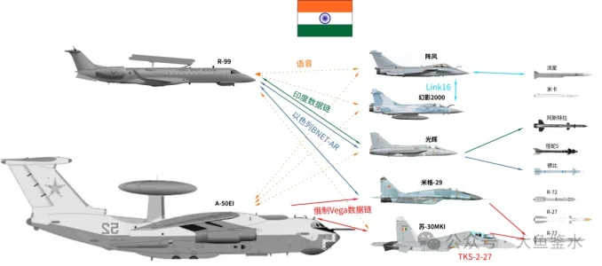

IAF is in a precarious situation. No IAF BVR missiles can get mid course updates from AEW&Cs or a UAV relay. This means they need to guided by the shooter itself or a buddy shooter, they will be under threat from PL-15 and PL-17 and may not be able to provide mid course updates throughout to ensure good PK. Where as PAF or PLAAF shooter can engage in truly fire and forget tactic, shooter fires BVR and then rely on AEW&Cs or UAV relay to guide the missile via Chinese datalink.
Only solution is to develop a local tactical data link system like Link16 or 17. To update ASTRA missile series to work with this datalink. Re platforms, update SU30MKI, MIG29UPG, LCA and our AEW&Cs with this datalink. Not sure if french platforms can be updated without huge OEM costs.
Till then, IAF will have to be defensive in air to air engagement and relying on SAMs like S400, MRSAM and Kusha (in future for area denial). Longer range air to surface standoff weapons like Brahmos, Rudram 2 & 3 will provide deterrence against PLAAF and PAF (they are specially vulnerable to it).

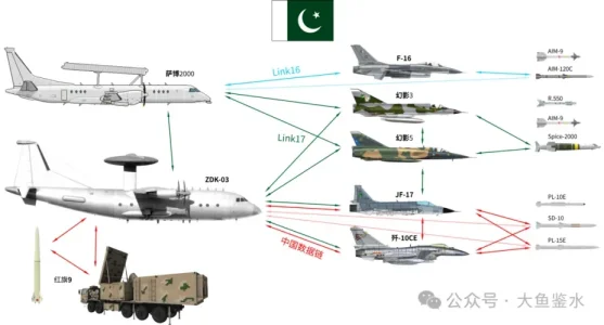

SAAB Erieye cannot guide Chinese AAMs, western datalink cannot be used to guide chinese missiles, this has already been discussed. PAF's chinese AWACS are already retired btw. I don't know about whether PLAAF AWACS are able to guide their AAMs or not, that is debatable.

There is absolutely no way pakistani have common data link
Period
Especially to indians who are propagating it by reading some stupid reports
Link 16 and link 17 can never be interested connected
A basic system design engineer working in this field will tell you how that's possible without humongous work or cooperation btw america and China
Period

I agree we have datalinks that connect AEW&C to shooters like BNET-AR, etc. But the datalink for BVR missile guidance is only from shooters, our AEW&Cs do not have the ability to provide these updates directly to BVR missile. This is the capability gap vis-a-vis PLAAF and PAF now. For example, the ku band datalink for Astra mk1 is on the Astra launcher pylon itself. We have the ability for a buddy (different from actual shooter) to guide missiles but these are fighters too and unlike AEW&C or UAV relay (beaming updates from ground station) will be in the threat envelope of PL-15.
Why do you think we saw no wreckage of our AAMs in Pakistan, I think J-10 were zooming in and launching (lofting) PL-15s and then turning cold as they relied on AEW&C or an UAV relay to guide those missiles, thus denying us an opportunity to fire back. One thing I missed in my initial post, maybe integration of loyal wingman like Cats Warrior with Astra missile coupled with SU30MKI can complicate the situation for PAF and allow IAF to play to it's number advantage.

Look mate
Our awacs can share real time data and location of enemy aircraft but guiding it depends on missiles capability
Definitely pl-15 has that capability but the point is they need chinese datalink bcoz link-16 cannot be integrated with chinese platforms coz that would risk a lot of data and systems critical info under nato
The reason pakistani fired and went back not bcoz their awacs was providing relay to pl-15 but that's their strategy like what they did during swift retort baiting the aircraft to their air defence zones and then shoot it down or other aircrafts waiting for it
We fired bvr or not and why was it fired is a different topic coz we had to follow RoE laid by the govt
And mostly the awacs which was on the air was saab not chinese making it sure that awacs wasn't guiding the missile
And moreover it's and active guided missile
