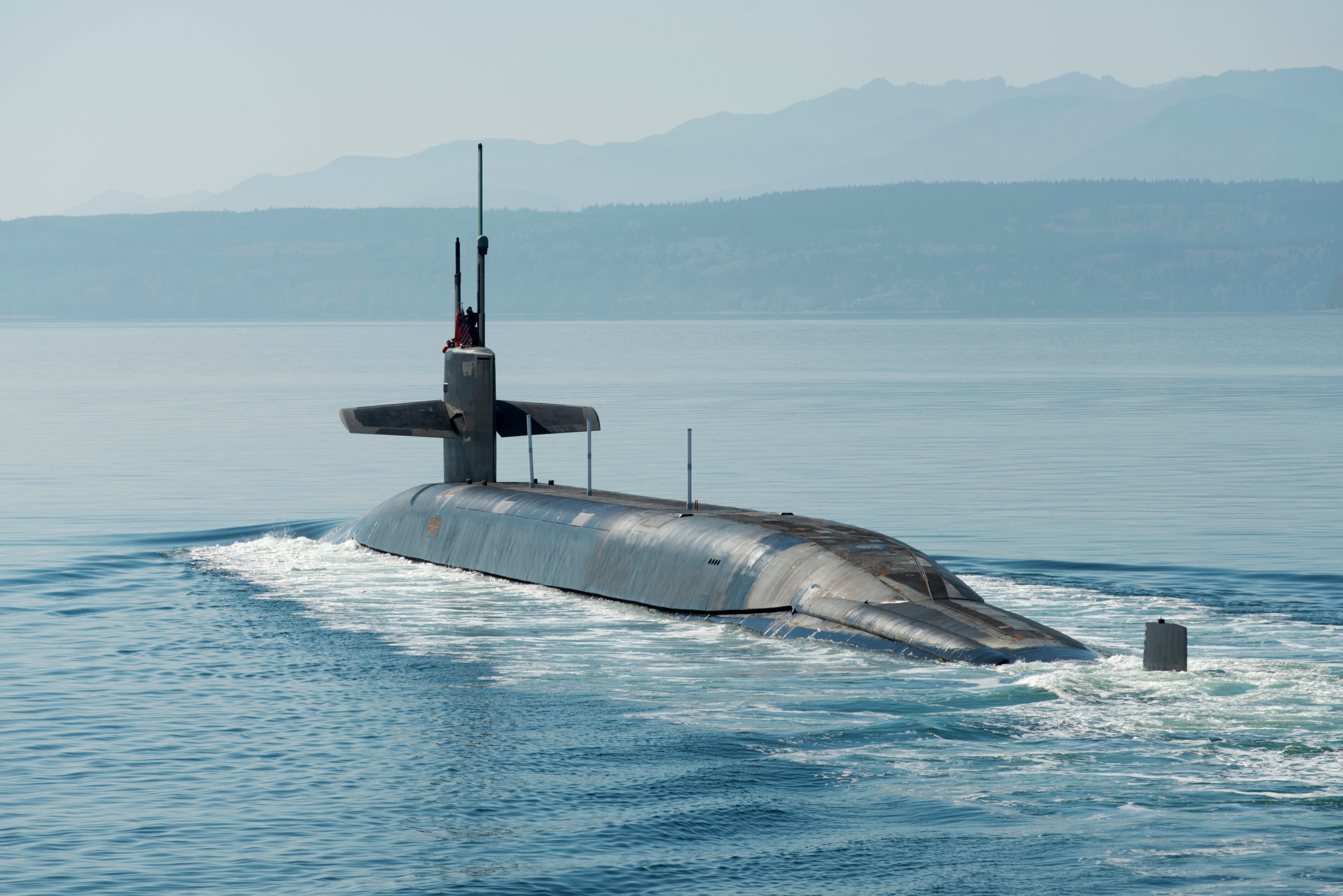

The beam of Ohio and Delta IV is not that different (13.0m vs 12.3m = 0.7m diff), but the Ohio's Trident-II missile is much shorter than R29RMU Sineva (13.6m vs 14.8m = 1.2m diff). The difference amount of 0.5m is largely the reason why Delta (pic above) needs the huge hump while Ohio's hump is comparatively more streamlined:
Missile dimensions are key to determining the hump. Where the missile is even shorter (like France's M51 which is only 12.0m) the hump on Triomphant is totally non-existent:
