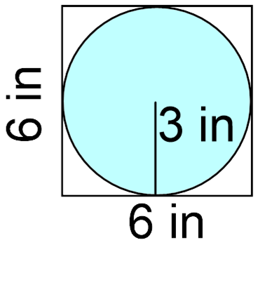

Then even it would fit into it if the diameter is smaller than the sides of the square.
Point is, a round-silo has less space than square one. Following is Shaurya sub-based launcher & it'd hold 4 if it were square.1631540134971.png

The thing is, Barak 8s (not the ER version) ARE small enough to be quad-packed as they are even slimmer than the ESSM.
main-qimg-1aa3838022db4ee1e5731f797534152e
Which one has more room inside - the square or the circle??
