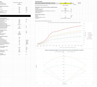

Range wise it will be improvement over all Indian fighters in service, competitive even against Russian Irbis or US APG-82 for F-15EX. in high PRF (250 KHz) It is able to pick a 3 sqm target in 296 km range. Remains to be seen tho how India will use that range advantage.
Well with great power of course comes cost. I also made an estimate for the cost of the array. and comparison with earlier N011M Bars. That compared to Bars. Virupaksha may cost 3-6 Times not including the development cost against Bars.
The cost estimates are made on assumptions of 272 radars production run, 95% "learning curve" factor and sidelobe reduction effort (yes that cost too) to match N011M's excellent average sidelobe level (-48 dB)
The advantage of some Twice the PD-90 range however might worth the cost, not including improved reliability of TRM vs Tube transmitters.
