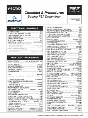

Pre-flight checklist includes everything we can imagine. It has become digital.
"Cold & dark start" videos of both sims & real jet are there on YouTube.
The pilot has to program the FMC (Fight Management Computer) before each flight about -
- source, route & destination
- weight carried / MTOW
- V1, V2, Vr
- weather conditions
- flight limits of RPM, speed, altitude, EGT (Exhaust Gas temp.), etc at take-off, flight.
OPTIMUM/AUTO options are avaiable for each parameter but although highly unlikely but THEORETICALLY, if pilot sets inacurate limits then it can be disastrous.
This might be a hypothetical example if full throttle is opened then EGT goes high, but EGT limit is lower then it might reduce thrust & lift. so FMC programming needs to be done carefully.

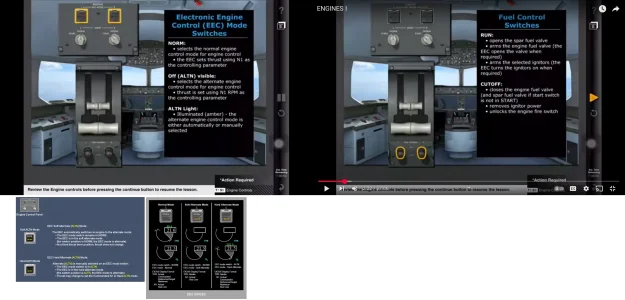

There is Electronic Engine Control or EEC also, After achieving sufficient N2 rotation, the EEC Is powered by its associated PMA, (Permanent Magnet Alternator).
It continiously monitors throttle, provides protection against flame-out during ecess rain, hail.
It monitors N1, N2, N3 spool speeds also & if RPM limit crossed then fuel flow would be reduced to lower the RPMs.
The EEC shuts down the engine only if RPM limiting fails & overspeed condition occurs.
If fuel-switch is accidentally shut off then EEC can electronically turn it & ignitors on.
There is TAP (Thrust Asymmetry Protection).
On ground it'll shut down engine if above idle speed and not decelerating normally.
During take-off if 1 engine fails then TAP reduces thrust on surviving engine to safeguard rudder/yaw control.
TAP is only available when flight controls are in normal mode.
The Airborne Vibration And Monitoring System tracks engine vibration levels (Rotor Imbalance), which is displayed on the secondary engine display, including the source. i.e., N1, N2 or N3.
Engine Failure Alert System - During takeoff (When the engine is producing less than the commanded thrust from 65 knots to slightly below V1), a time critical warning happens - A siren followed by voice annunciation ENGINE FAIL; Illumination of the red MASRER WARNING lights; PFD and HUD warning message ENG FAIL.
