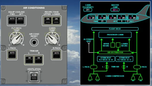

I guess the AUTO setting of AC packs would shut them down or to minimum in emergency to prioritise power to critical avionics, hydraullics.
