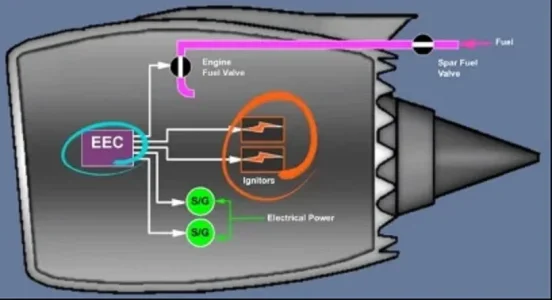

Remember what i said since my 1st post about EEC, TAP, TCMA & possible glitch -
It continiously monitors throttle, provides protection against flame-out during ecess rain, hail.
It monitors N1, N2, N3 spool speeds also & if RPM limit crossed then fuel flow would be reduced to lower the RPMs.
The EEC shuts down the engine only if RPM limiting fails & overspeed condition occurs.
If fuel-switch is accidentally shut off then EEC can electronically turn it & ignitors on.
On ground it'll shut down engine if above idle speed and not decelerating normally.
During take-off if 1 engine fails then TAP reduces thrust on surviving engine to safeguard rudder/yaw control.
Last but not least, if the air data sensors are clogged then it can be big problem. Although there are multiple of them for redundancy but accidents due to them have happened.
The ANA 787 incident happened in 2019 & if we deep-dive into the cause then it is complicated.
Boeing clarified that the engines can shutdown as thrust reverser were activated too quickly before ground condition achieved which activated the TCMA or Thrust Control Malfunction Accommodation system which guards against inadvertent asymmetrical high thrust situations. The TCMA would notice high thrust at idle or low speeds on ground w/o decceleration, so engine would be shutdown to reduce speed.
But this is takeoff situation. So i can think of an ECC glitch
- As RAT can auto-deploy when engines below idle RPM, an EEC glitch detecting high EGT for long could reduce thrust by reducing fuel flow. Although such glitch is very difficult to imagine.
MCAS glitch caused 2 crashes of B-737 MAX.
So it is also possible that sensors+EEC glitch can reduce RPM or shut down engines & in the MFD it'll appear like a cutoff operation & the FO being far less experienced than Captain, can misunderstand.

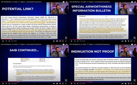

>The SAIB for fuel switch was released in 2018 but not followed by Air India as it was advisory, not mandatory. This can be negligence, over-confidence over component performance.
Now this new video by a foreign pilot on the SAIB says that fuel switch in various Boeing models are identical & can have mechanical problems if installed with "locking feature" disengaged.
View: https://www.youtube.com/watch?v=VI4fY-CJ1DQ
> A comment on his video reveals that in Embraer jets the fuel cutoff won't be done unless the throttle is pulled back to idle.
"Embraer will not let you shut the fuel off or close the fuel valves unless the throttle aren't at idle. To just kill the fuel with both engines at full TOGO is unbelievable."
This is perhaps a safety feature & in Boeing too, as per 1x engine failure/relight procedure during take-off in B-787 (YT videos) -
- the fuel switch red light turns on.
- Surviving engine is enough for +ve flight.
NOTE - This doesn't auto-start RAT or APU unless additional conditions ar met.
- Both pilots coordinate to follow checklist & acknowledge each other t every step.
- The MFD displays probable reason like fire, etc.
- Auto-throttle switch for affected engine is switched off in UFC panel.
- Affected side throttle is put to idle.
- THEN AFFECTED SIDE FUEL SWITCH IS CUTOFF.
- Fire handle of affected side is pulled up & turned to discharge fire bottle.

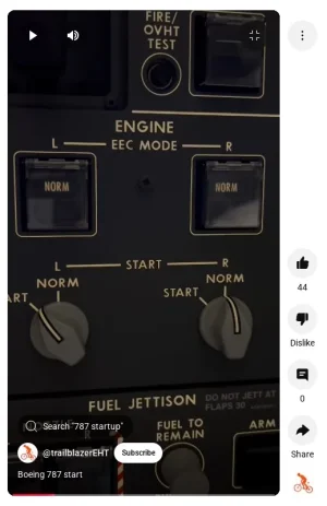

View: https://www.youtube.com/watch?v=XZVc3npAltA
This procedure takes time. But in dual failure it is instant emergency. based on this procedure, the pilots should immediately check for fire & if no fire then -
- switch off both auto-throttle switches in UFC panel.
- pull back both throttles to idle.
- switch off both fuel switches then on.
- Either EEC should auto-arm & light the ignitors or engine knobs in overhead panel need to be rotated from NORM to START.
So it is basically a 3-point operation -
- Auto-throttle switch off in front.
- Pull throttles back.
- Switch off fuel switch.
THIS MEANS AS PER S/W CONTROLLED PROTECTION THE FUEL HARD SWITCH CUTOFF OPERATION WILL NOT BE RELAYED FROM FMC TO EEC UNLESS THE THROTTLE IS PULLED BACK TO IDLE.
SO THIS WHOLE ACCUSATION OF CAPTAIN (FAR MORE EXPERIENCED THAN FO) SWITCHING OFF FUEL SWITCHES IN 1 SECOND WHEN THROTTLE IN FORWARD POSITION, IS TECHNICALLY IMPOSSIBLE.

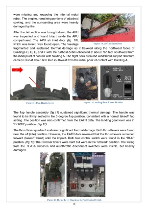

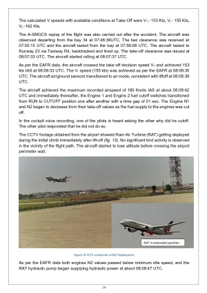

Preliminary Crash report key points -
> Entire nation waiting for report in working day hours, but Report released in after-work hours IST after midnight.
> Data from forward EAFR downloaded on 24th June 2025.
49 hours of flight data spanning 6 flights including crash flight.
> Rear EAFR significantly damaged. Data couldn't be downloaded by conventional means. >>>>> No info if unconventional means tried or not.
> Earlier an error message 'STAB POS XDCR' or "Stabilizer position transducer" was about the sensor sending data about stabilizer to FMC, which was troubleshooted.
> T/o weight was 213,401 Kgs loaded Vs 218,183 Kgs allowed. >>>>> More weight adds to more loss in altitude. But i guess this is done till allowed limit by all airlines.
> No pilot names or captain/FO mentioned for conversation from CVR. >>>>> WHY????
Only 1 line mentioned about one asking other why he cutoff fuel & other saying he did not. >>>>> Why not full conversation from T/o roll till crash????
> A/c departed from bay-34 at 7:48:38 UTC/GMT, started rolling for t/o at 8:07:37 UTC/GMT, so 19 mins from bay to t/o roll.
> MLG was seen tipped forward (happens when gear lever put up) but gear lever found in down position!!!! >>>>> Perhaps it moved down due to crash impact.
> Thrust levers found at idle but EAFR data says they remained forward till impact. >>>>> Again, perhaps they moved back due to crash impact.
> Fuel switches were found in RUN position (as expected for relight).
> The SAIB in 2018 to inspect the fuel switches & take suitable action. >>>>> Was this done for AI-171??
> N2 spool RPM passed below idle before restart attempt. >>>>> here an engineer or 787 pilot needs to comment if the fuel switches can be switched back on immediately within say 5 seconds after checking fire.
> RAT deployed as expected, captured by another CCTV from left side, >>>>> WHY not shared to media earlier???????? For TRP of all media channels???????
> Engine 1 (left) recovered in 1 attempt, altough late. Engine 2 (right) 1st attempt recovery failed.
> Fuel samples testing from fuelling bowsers & tanks showed no contamination.
> Fuel samples from APU filter, refuel/jettison valve ofleft wing yet to be tested.
> Timeline -
8:8:39 UTC/GMT / 1:38:39 pm IST - take-off, left runway.
8:8:42 UTC/GMT / 1:38:42 pm IST - speed 333 Kph, fuel cut off to both engines in 1 second interval.
8:8:47 UTC/GMT / 1:38:47 pm IST - Both N2 spool RPM went below Idle; RAT hydraulic pump started supporting flight controls.

Time T = take-off
+3 seconds
T+3 sec = fuel cutoff to both engines.
+5 seconds
T+8 sec = N2 spools RPMs below idle; RAT hydraulic pumps on.
+5 seconds
T+13 sec = engine 1 switched on, worked.
+2 seconds
T+15 sec = auto APU start, inlet door opened.
+2 seconds
T+17 = engine 2 switched on, didn't work.
+9 seconds
T+26 sec = Mayday call
+6 seconds
T+32 sec = crash, recorder stopped.
After fuel cutoff -
> RAT deployed immediately & took 5 seconds to start its hydraulic pump (& electricity too).
> APU autostart took 12 seconds to initiate.
> Engine 1 was switched on after 10 seconds.
> Engine 2 was switched on after 14 seconds (4 seconds after engine 1).

Everything would have been clear if they mentioned if CVR picked up the noise of fuel switch or not.
I remember watching about some other crash where they found out gas(O2?) leak by checking the audio recording, so I am sure toggling of fuel switches must have been audible as well.
May be you missed some critical technical points.
Even if CVR picked the click of switches, it won't work if S/w protection is there, unless auto-throttle disengaged & throttles pulled back to idle.
You expect Captain, far more experienced than FO, to do this kind of procedural mistake or suicide which might have S/w safeguard?
