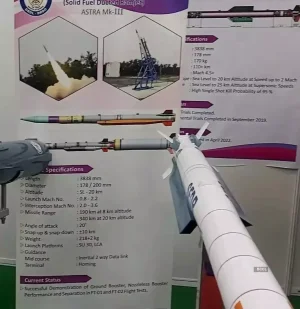

Check the DRDO posterAstra mk3 will be solid fuel missile.

It's a solid fuel ramjet, the same as in the Akash 1 and its variants!!Check the DRDO poster
Yes, same class as meteor. What I meant is that it is not a typical solid fuel/stage AAM like Astra mk1,2 & PL15.It's a solid fuel ramjet, the same as in the Akash 1 and its variants!!
