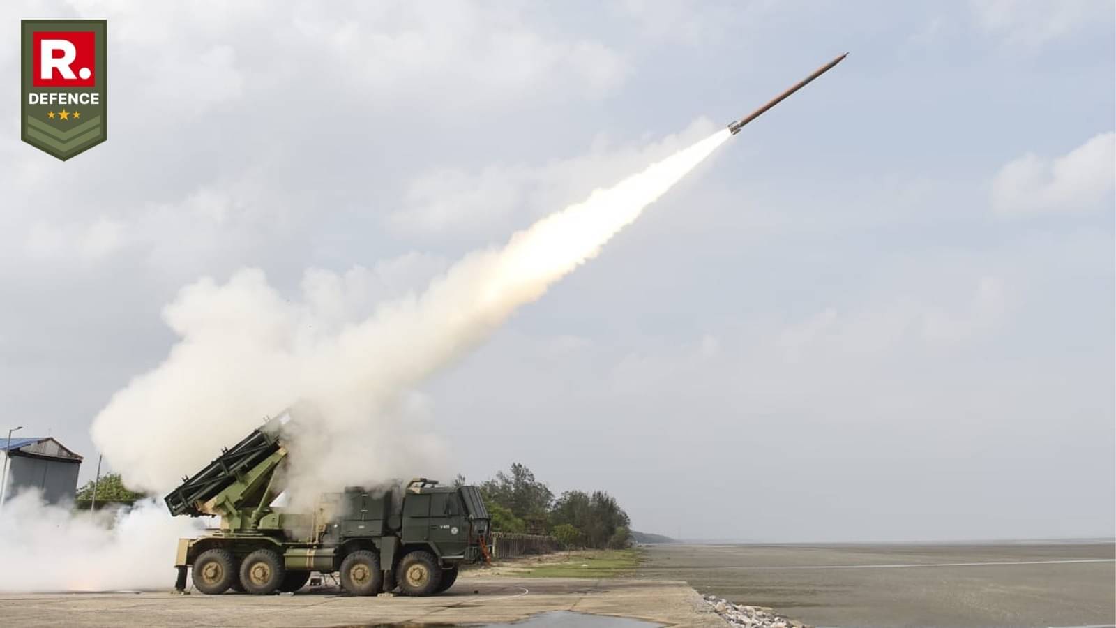

A fatter shorter rocket would be DRDO's 300mm pinaka rocket, which current launchers can easily carry.

Whatever happened to the Naval-Pinaka some were talking about a few months back?
Was that just vaporware or real?
Naval and Air Force Plans for Pinaka System Integration​
Beyond the Army, DRDO is also working on specialized variants of the Pinaka system for the Indian Navy and Air Force. In particular, the naval version is designed for underwater operations and submarine countermeasures, with an impressive range of 75 km. The first trial of this naval variant is scheduled to take place later this year, marking a significant step towards enhancing India's naval defence capabilities.

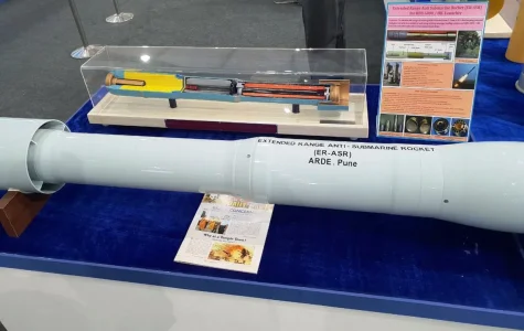

Coz we know, ARDE already has developed extended range ASW rockets for the RBU-6000.
