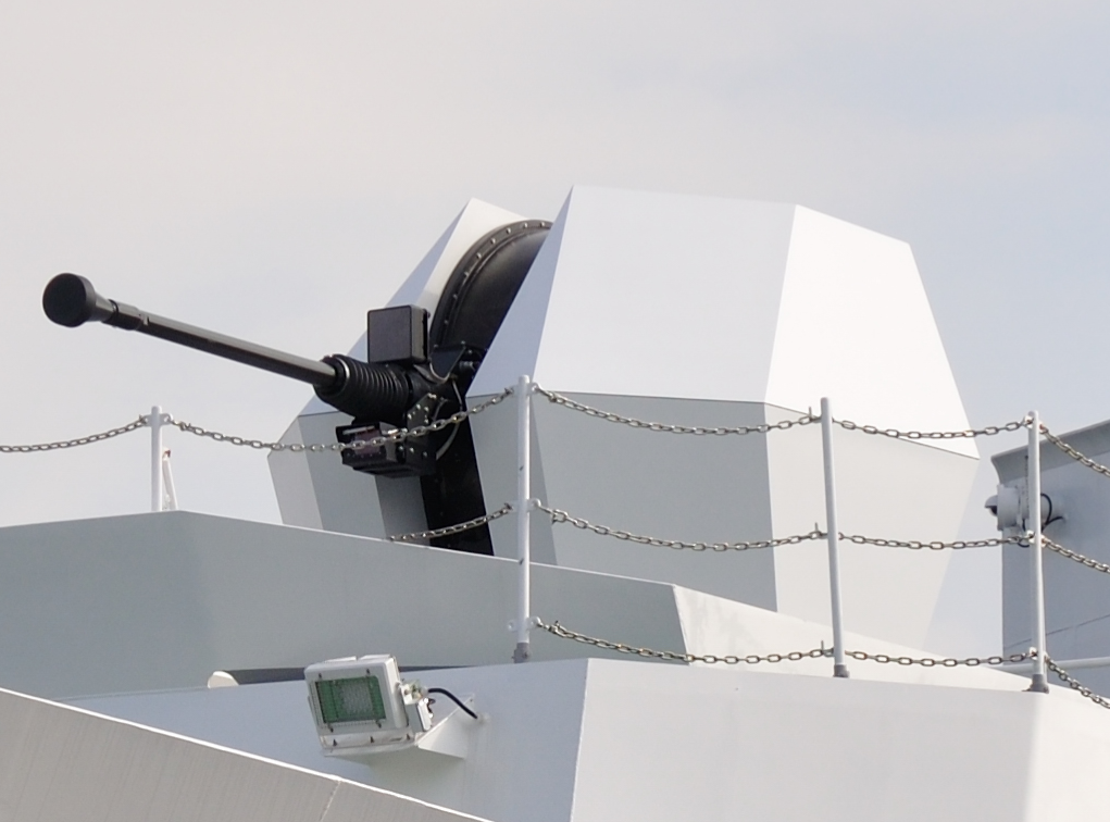

It's basically a 35-40mm auto-cannon with high fire rate, each shell fired is programmed when leaving the barrel for a timed airburst, supposedly more accurate against both drones and missiles
Other merchants have similar offerings
This is Burger-Anglo-Swedish
This is French
Oto Melara of Italy has a similar upgrade for the 76mm SRGM but there the projectile itself is guided, no airburst
On the Deshi end, DRDO has produced HEPF airburst shells for AK-630 and inducted by Navy
On private sector sides there is L&T Sudarshan CIWS based on Bofors 40mm L70 gun
The main benefit is with these smart airburst shells, you get a greater probability of deleting the drone/missile for lesser rounds spent rather than the gatling gun ciws where you spray high RPM shells hoping to physically hit the missile/drone using the sheer volume of dakka being put out
This is French

me point that smart airburst shells from high fire rate single barrel cannon is the future
"try to hit one missile with a 6 barrel gun's over 900000 rpm of lead output" is the past.
if you notice all the new ship designs world wide don't include muh phalanx anymore, including for burgers, it's for good reason, mainly because of drones but also because airburst seems to be better for taking out even missiles
