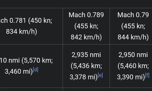

Looking at 737 specs, With 800kmph it won't have endurance of 11 hours.
Only massive benefit p8 has is response time, time to cover xyz area during war time. In peacetime C295 will be better option to share the load. It will cover easily 70-80% area that P8 can but will take a little more time.
"The P-8I Poseidon (used by the Indian Navy) and its American counterpart, the P-8A, are both based on the:
🔹 Boeing 737-800ERX (Extended Range) airframe"
It is a military-optimized version of the 737-800, modified specifically for the P-8 Poseidon program.
P8i have endurance with full fuel and it's equipment of more than 10 hours.
