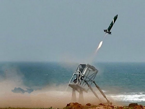

Drdo VSHORAD
Range ~6km.
Weight~20kg.
Warhead~2 kg.
Top speed~ mach 1.5
Designed mainly to be used against subsonic targets.
