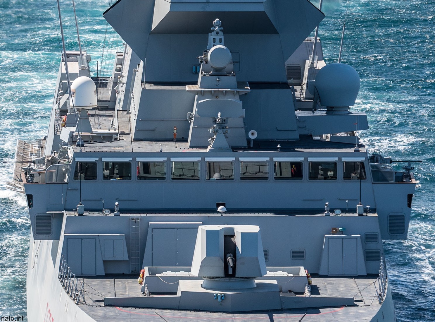

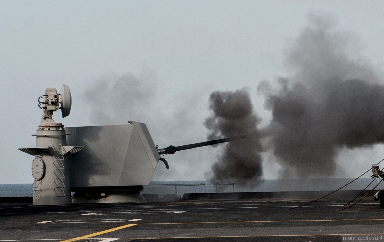

My personal copium for this is they are leaning into the Italian model of shooting missiles and drones with a 76mm cannon.
Strales/DART ammo combo called in PSU speak as "Upgraded Super Rapid Gun Mount" also fits with this.
Now how useful irl this is for shooting down missiles who knows?

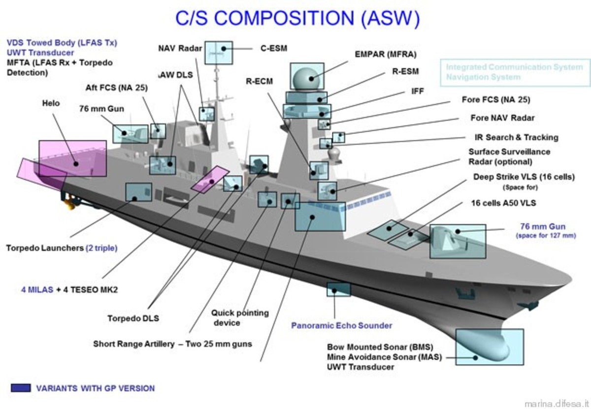

Anyway from what i've read here our CIWS weaknesses are
>Centrally directed AK-630, need per ciws radar and eo pod like phalanx and goalkeeper
>No RAM Launcher type missile/launcher combo and as per ayan barat no existing deshi missile either, for AMRAAM permissions will have to be taken from (((Anglo)))
>AK-630 cannon itself has shot dispersion issues

With the Nilgiri Class receiving the DART/STRALES 76mm guided ammunition as part of the upgraded 76/62 mm SRGM, the main gun can now be used in CIWS roles with the MF-STAR acting as the FCR.
It's good, maybe excellent given the dire state our CIWS is. First thing it'll do is cover one of the biggest blind zone in the frontal arc. Second, you'd missile like range from a "relatively" cheap ammo.
But again, as with any system this too has compromises. The bore is 76mm and DART is a sub-caliber ammunition so you don't have enough SWaP to mount any kind of fire-n-forget guidance. Instead it's kind of like earlier SACLOS ATGMs where you had to manually guide the round till it impacts.
So instead of firing rounds in quick succession at three approaching targets from different directions it'll engage only the first one and would be "occupied" with it till engagment is done. Then it'll lay to next target.
In comparison, a "dumb" CIWS would rapidly fire a burst at each of those three missile in quick discussion with first on the closest and last on the farthest. And then wait to see which one needs rengagment. And a missile based CIWS would just fire three or six missile simultaneously; either in fire-n-forget mode or guiding all of them individually using data-link.
