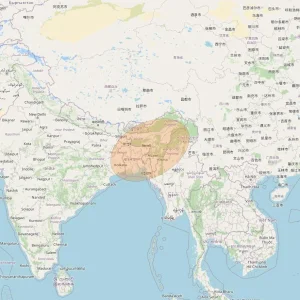

It was 4 user spot Ka-band beams and 4 user spot Ku-band beams to provide Village Resource Centres (VRC) in rural areas to bridge the digital divide of users including those in Jammu & Kashmir and North Eastern regions of India. It also features Q/V band payload, optical communication payload and GEO High Resolution Camera (GHRC) camera with telescope
@Varoon4
All these beams are active @Varoon4

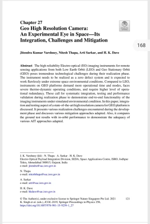

Thanks, great to know! Incidentally, we hear next to nothing about that high resolution camera on board GSAT 29. By now, 6 and a half years later, you would expect some information to have seeped through to the public. Is it because it's highly classified given its uniqueness and sophistication? If so( and I hope it's that) then best not to probe! :)
