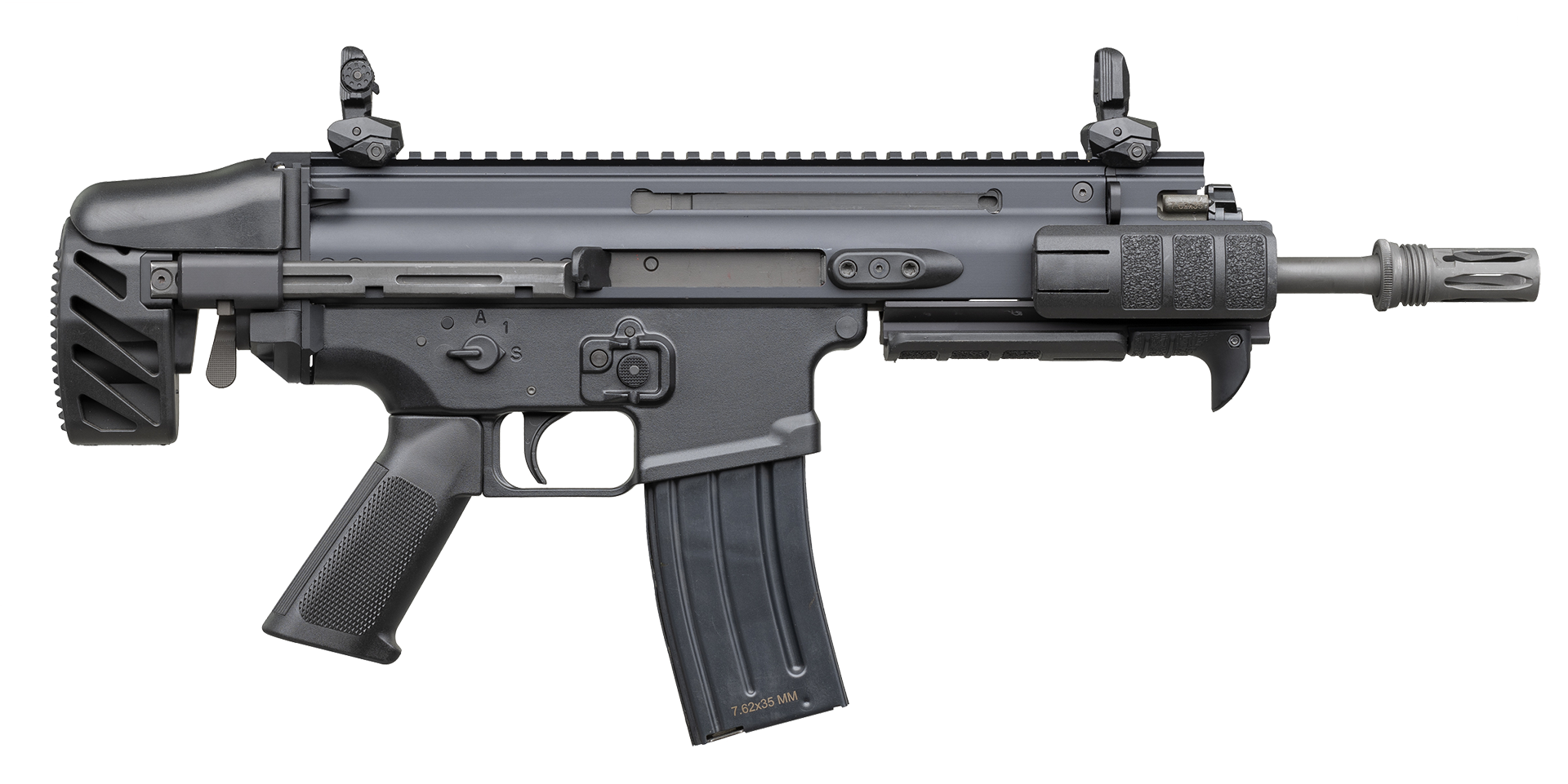

New standard issue weapon of a Central German state Police(Thüringen).
Transitioned from MP5 to Scar SC
Duty weapon and Training weapon
