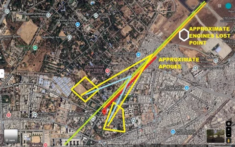

If T/o to crash is 32 seconds then engines must have failed around 8-10 seconds, 1/4th to 1/3rd of distance, 22-24 seconds remaining.
1 or both pilot(s) would try to look quickly at MFDs - error messages, RPM, electrical, hydraullics, etc, perhaps try to restart engines.
1 pilot may to scout the area; from security CCTV footage the jet does roll right little then left then centers, but a jet cannot maneuver much at such low altitude & short time of 8-16 seconds with emergency power from batteries + RAT also.
Excess pulling could have caused stall.
APOGEE or highest altitude was 625 ft. from MSL (Mean Sea Level) & 400 ft. AGL (Above Ground Level), 16 seconds remaining.

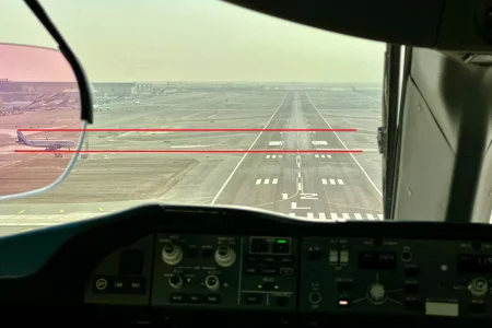

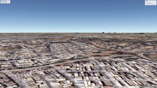

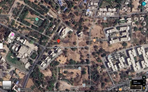

If we check Google Earth,positioning at approximate apogee point, at 400 ft., & look towards crash site, then the pilots would have seen something like this (16 seconds remaining) :
It was take-off phase, then loss of thust, so AoA (Angle of Attack) was high, hence downwards visibility of ground is very limited, but 787 windshield has good size & FoV (Field of View).
We can watch many landing videos on Youtube.
Now if we imagine trees, they will obscure the open land also, it is trigonometry.
If the pilot scouts an open land at apogee & steer with emergency power, then there are better chances.
The following are pics of -
- regular eye view in cockpit
- zoomed view out of clean flat terrain
Look at the height of tail of plane on ground through the left HUD. Trees can be even more tall than that.
I put the RED lines & we can see how much huge land trees can obsure.

If we combine the above pic & Googe Earth view, we get this:
So unless someone shares a drone view from apogee point at 400 ft., i think from cockpit PoV, the city dwelling around airport didn't give much chance to pilots.

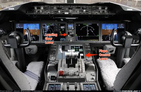

1. Pilot Error - No flaps/slats or landing gear retracted. - Not possible.
  • Captain Steve claimed on YouTube and in the media that the crash was caused by pilot error, but there is no indicative or definitive proof of it. I would rate it is a poor lazy analysis by someone who is qualified enough.
  • Even the two videos of the crash lack sufficient clarity to draw a firm conclusion. To avoid improper takeoff configurations, modern aircraft such as the Dreamliner 787-9 are equipped with a variety of safety features and alerts such as Takeoff Configuration Warning System (TOCWS) & EICAS (Engine Indicating and Crew Alerting System) that examine the config & checklist followed are well within the safety threshold of the aircraft even before taxing to the runway commences.
  • From the crash images while examining the wing, we can observe that the slats are extended forward and the flaps are at setting 5, which is appropriate for takeoff.4858.webp
  • Additionally, it is evident from the terrace video that the landing gear is in the retracted position. This indicates that after a positive rate of climb was verified, the First Officer raised the landing gear per the Captain's instructions but was stuck open due to power loss immediately after the under carriage lever was pulled.
    View: https://www.youtube.com/watch?v=2ZwzACp-q9U
  • The landing gear and flap levers are located separately in the cockpit, it is extremely unlikely that a skilled crew member would use the incorrect one as suggested.

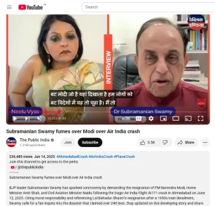

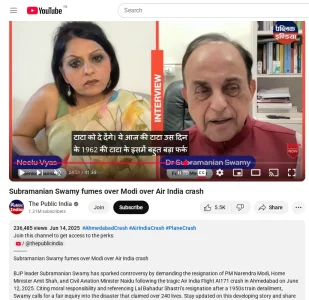

Subramanian Swamy said AI171 crash should be investigated as conspiracy.
In interview to media he calls Narendra Modi as "chuha"(mouse) bcoz he doesn't open his mouth in front of USA, EU to take action against terror supporting nations like Pakistan & its allies.
He liked J.R.D. Tata but doesn't have confidnce over present day TATA group for super sophisticated tech like aircrafts. He said giving Air India to TATA group was mistake. BTW, his wife Roxna is Parsi/Zoroastrian, like Tata family.
View: https://www.youtube.com/watch?v=ZnaZ1yEKlyo

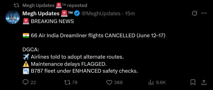

This tweet sounds as if AI has 66 787 aircraft's , they should have mentioned 66 flight routes cancelled which are to be operated by 787 ..
Dont expect anything from these tg handles. All they care about is giving breaking news style headlines with half ass based research. They are known for jumping to conclusions based on unverified news and exaggerating it.
