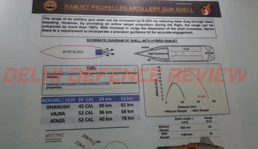

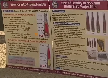

Most likely this is the Ammo the Article is talking about @Blood+
according to this brochure army is planning to replace it's old ERFB Shell (Those characteristic Nubbed Shells) with Bourrelet Shells not only capable of withstanding higher Chamber Pressure but also allow for enhanced Barrel Life
Yep, that's definitely it, great find. Plus, a new DPICM round as well.
As far as I am aware these are all the rounds we are working on, which covers the entire spectrum
Next Gen PCB Shell (Penetration Cum Blast)
HRAP Shell (Hybrid Rocket Assisted Projectile)
Next Gen HE Shell (High Explosive)
Next Gen HE-BB Shell (High Explosive Base Bleed)
Next Gen DPICM Shell (Dual-purpose improved conventional munition) (submunitions)
Next Gen Smoke Shell
Next Gen Illuminating Shell
Ramjet Powered Shell
Guided Artillery Shell
