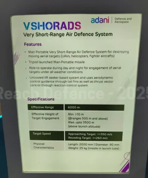

Very Short Range Air Defence System or VSHORAD is a man-portable infrared homing surface-to-air missile system designed to eliminate low altitude aerial threats like helicopters, unmanned aerial vehicles etc at close ranges.
VSHORAD missile system was designed and developed by Defence Research and Development Organisation's (DRDO) Research Center Imarat (RCI) with the goal of replacing older Igla M MANPADs from the Indian armed Forces.
Indian Army and Air Force are expected to collectively order a total of 1200 VSHORAD missile and 200 Launchers by the end of FY 25-26.
What makes the Indian VSHORAD different from MANPADS present around the world is the presence of miniaturized Reaction Control System which drastically improves its precision in the end game.

Current VSHORAD and Stinger/Igla have totally different use cases, VSHORAD is not man portable like Igla/Stinger
VSHORAD devlopment is split in 2 version
First one being the classic VSHORAD currently nearing testing completion with
• MISTRAL like static twin launchers
• Single Pulse Dual Thrust (achieved using variable grain geometry) Rocket Motor
•On the heavier Side with missile weighing around 19kgs
• Differential Thrust Exhaust Nozzles and 40 RCS thrusters in the back of the missile for high maneuverability in Sub 200 m range
This version will be mainly used by naval ships( RIM 116 equivalent), Helicopters, and Ground Vehicles, (human Launch is not the main goal)
View: https://youtu.be/16JFfy9Jx7E?si=2mDFINs01k9rHul-
There is another version in development (Shoulder Fired VSHORAD) which is lighter and Simpler and is the actual replacement for Igla, until that version comes online, Igla/Stinger will kept on being imported
This Version will have
• Igla like Launcher (old refrence pic)
• Lighter and Smaller by a Margin 12.5 kg ang 70mm diameter compared to 19 kg and 90 mm diameter
• Dual Pulse (but no dual thrust) Motor
• More Simplified Design by removing Differential Thrust Exhaust Nozzles and moving RCS thrusters towards the front
