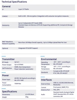

Did some AI research:
BNET-AR is designed as a broadband IP networking solution for large-scale airborne operations, supporting up to 1000+ users with high-capacity data sharing across multiple platforms.
MADL is a stealth-optimized tactical data link specifically designed for small groups of 5th-generation aircraft operating in high-threat environments, prioritizing low detectability over network scale.
Technical Specifications
Frequency Bands
  • BNET-AR: 30-512 MHz (VHF/UHF), with optional L-band and S-band extensions
  • MADL: Ku-band (12-18 GHz)
Data Capacity
  • BNET-AR: >100 Mbps overall capacity, up to 10 Mbps per user upload rate
  • MADL: "High data rate" (specific rates classified, but optimized for tactical data sharing rather than high-volume networking)
Network Scale
  • BNET-AR: Highly scalable (+1000 users), designed for large force operations
  • MADL: Limited scale (typically 4-ship flight groups), designed for coordinated stealth operations
Range & Coverage
  • BNET-AR: Wide-area coverage using lower frequency bands with better propagation
  • MADL: Shorter range but highly directional beams for stealth preservation
Operational Differences
Mission Focus
  • BNET-AR: Multi-domain operations, supports various platforms and mission types with emphasis on high-capacity networking
  • MADL: Stealth air operations, specifically F-35 coordination in contested environments
Interoperability
  • BNET-AR: Open architecture (VITA 65), SCA 2.2.2 compliant, supports multiple waveforms including custom ones
  • MADL: Proprietary US system, limited to specific platforms (F-35, planned for B-2)
Detectability
  • BNET-AR: Standard ECCM with frequency hopping and spread spectrum
  • MADL: Advanced LPI/LPD (Low Probability of Intercept/Detection) specifically designed for stealth preservation
Platform Integration
Physical Characteristics
  • BNET-AR: Modular system, 10kg, 700W max power, 1/2 ATR Short form factor
  • MADL: Integrated into F-35's CNI system using embedded phased array antennas
RF Capability
  • BNET-AR: Up to 3 independent 50W RF heads for multi-channel operations
  • MADL: Integrated directional antennas optimized for stealth aircraft geometry
Strategic Implications
BNET-AR represents an exportable commercial solution suitable for allies and partners seeking advanced airborne networking capabilities for conventional operations.
MADL is a restricted US capability designed specifically for maintaining technological superiority in stealth operations and is not available for export.
