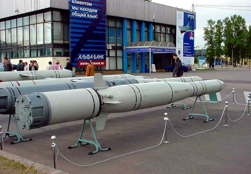

Has India ever considered getting the Club-N or Club-S missile given that the UVLM for BrahMos was originally based on the USKS VLS for the Kalibr (Klub) missile. This will give us an ASROC capability of sorts.
Note : 91RTE2 anti-submarine ballistic missile (Club-N) differs from 91RE1 missile in size and booster design
Main characteristics:
Length, m:
  • 91RЕ1: 7,65
  • 91RТЕ2: 8,916
Diameter, m:
  • 91RЕ1: 0,534
  • 91RТЕ2: 0,645
Weight, kg:
  • 91RЕ1: 2100
  • 91RТЕ2: 3105
Operational range, km:
  • 91RЕ1: 5…50
  • 91RТЕ2: up to 40
Sustainer portion flight speed, m/s:
  • 91RЕ1, 91RТЕ2: up to 830
Warhead weight, kg:
  • 91RЕ1, 91RТЕ2: 500 (length 3.2, caliber 0.35)
Guidance system type:
  • 91RЕ1, 91RТЕ2: united inertial+ acoustic target seeker
