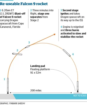

Maybe this has been asked before but why is ISRO purposely avoiding a two stage partially reusable launch vehicle ?
F9 lands 300km down range in sea, whereas distance between Sriharikota to Malaysia is 2000km approx. ISRO can easily re-enter upper stage above Philippine sea or beyond ?
This doesn't make sense. What am I missing here ?View attachment 36462
2 stage vehicle with 10T to GTO payload using LOX Methane is very difficult even with advanced materials...u need insane structural factors, almost impossible to achieve, hence 3 stage
No! A two stage vehicle is simpler, LESS RISKER & CHEAPER. The last two are exactly what ISRO needs to up it's launch cadence. No one builds 3 stage rockets anymore
I am failing to see why ISRO is not building a two stage launch vehicle
I have just explained you in my above post why two stage to orbit is not technically feasible for 10T GTO payload requirement, read again. You have to break laws of Physics to achieve that, even NASA or SpaceX cannot achieve that
Wait a minute ! Who said we have to use methlox in upper stage ? Because I surely didn't !
My only question is why we don't build a 2 stage LV with reusable 1st stage. THAT'S IT
New glenn - 13.6 t to GTO
And BTW a 4-6t to GTO & 10-16t to LEO would suffice our 99% of needs
