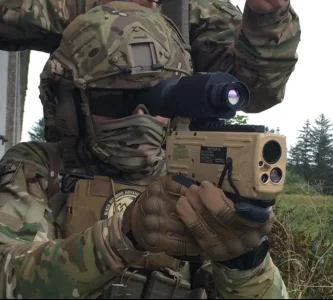

> Most of the times this reflected signal comes from GLTDs (Ground Laser Target Designators) or even HLTDs (Handheld...) carried by SpecOps squad that has infiltrated close to the enemy position
> This role is so important that serious forces like USAF maintain a separate division called TACP or Tactical Air Control Party whose whole training is just doing this

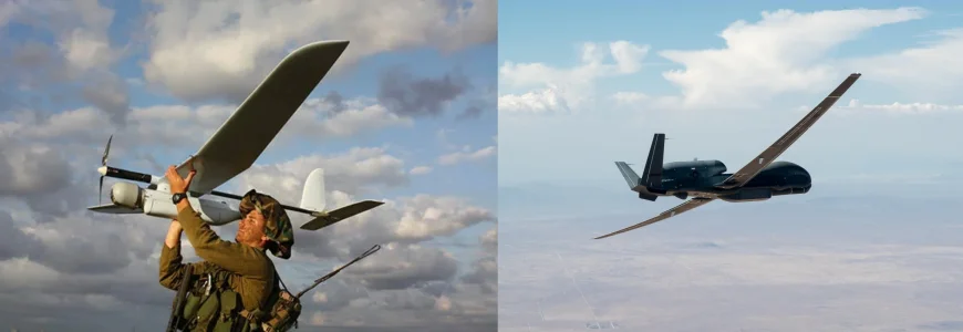

> In recent years this role is being complemented more and more by UAVs as it's far less risky. The whole idea of UAV is that it'd either be so small that even if it gets shot while designating then also the loss would be insignificant or fly so high (10km+) that it'd be out of range for most of the SHORADs.
Both are pictured below
Whatever I wrote is pretty much the SoP for using Laser Guided Munitions for more than a decade or so.
