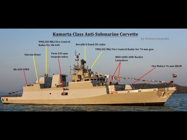

The VL-SRSAM can be put under the FFBNW (Fitted For But Not With) category until we see the launch of the actual ship.
This the render of the Kamorta Class and the final configuration for configuration.
However, without VL-SRSAM these vessels will be absolutely toothless to protect an ASW squadron (1 x Kamorta Class, 4 x ASW-SWC).
Imagine if during actual launch it turns out that the only air-defence other than two AK-630s are 2-4 Twin VSHORAD launchers...keeping with the IN's legacy of using Strelas on Veer/Khukri/Kora 💀
This the render of the Kamorta Class and the final configuration post commissioning.

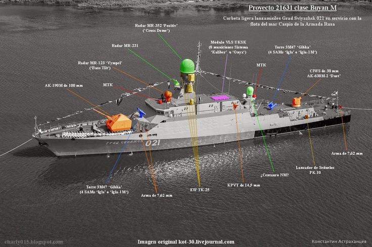

The NGMV is thus analogous to the Buyan Class.
Since there is no helipad on the ship, we cannot even deploy a modular Tor like missile system onto it as an interim measure like the Russians.
