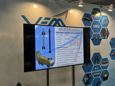

Apparently VEM Technologies showcasting few cutting edge weapons during this Aero India and now.
Their own SA missiles = Ajitha
SR- 25KM
LR-75KM
Previously showcased the ATGM.
Now showcased an MANPADS.
They generally work with DRDO as Production partner. Looks like they are using the TOT and tweaking the system with their work.
But currently we could not find any Testing images or live version of the products. Only models I can see.
They are going to have two kind of missiles .
1st layer - unguided missile with fragments to take out area of 20meters of swarms .
2nd layer - guided missile for individual targets .
Additional layer of jammers and soft kill .
Will be based on movable platform and can operate over 5000m altitude .

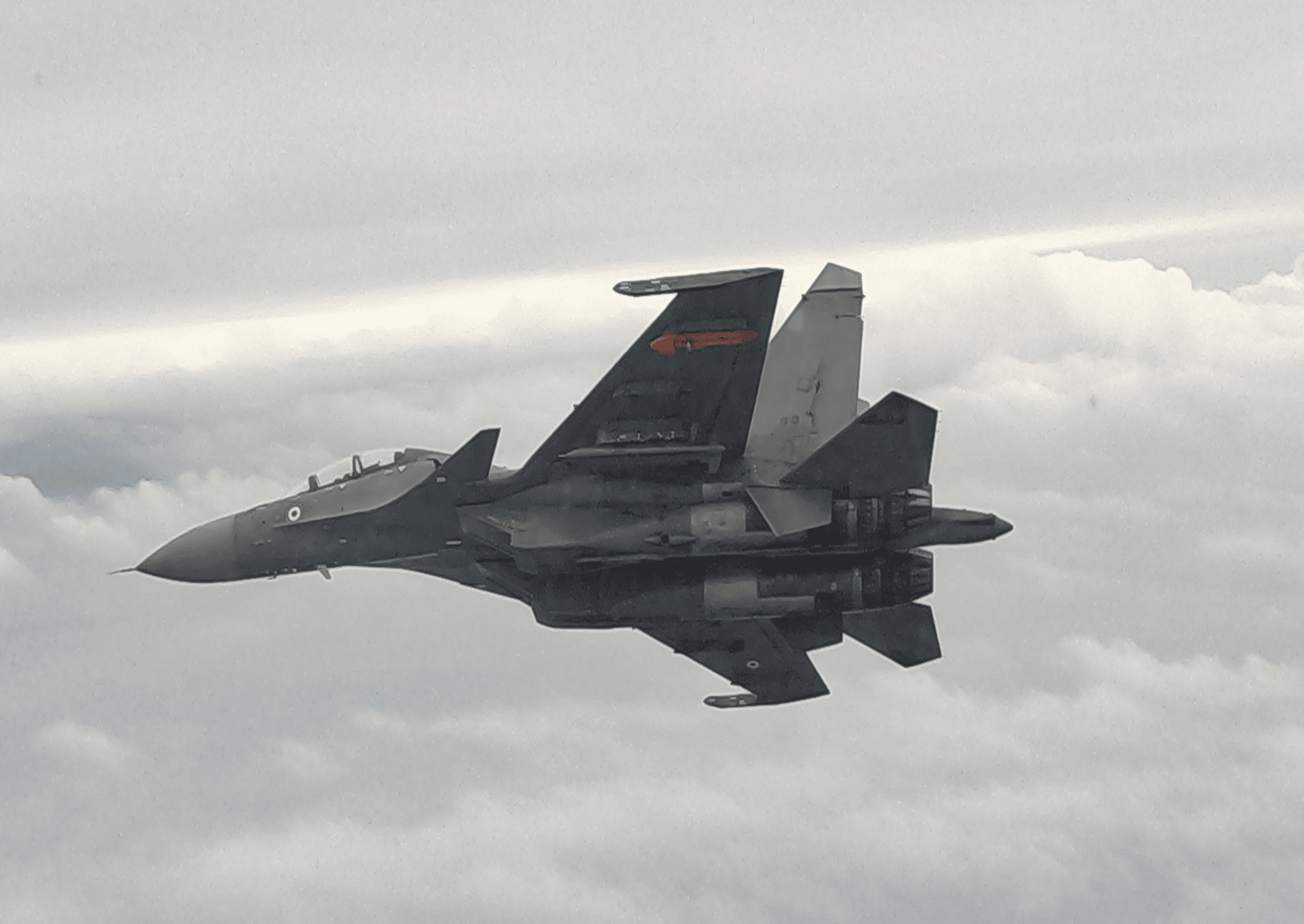

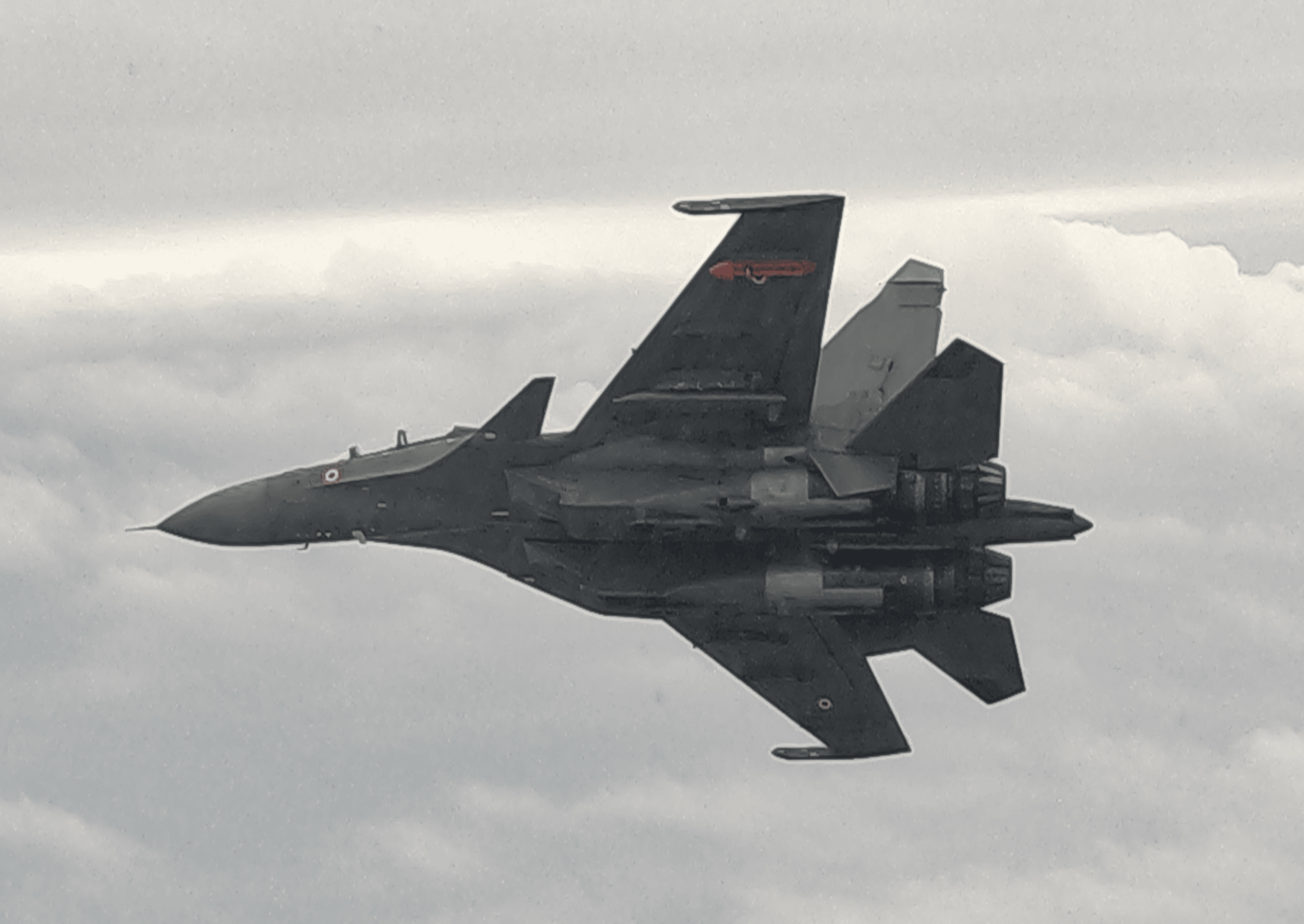

LRGB Integration on SU-30
