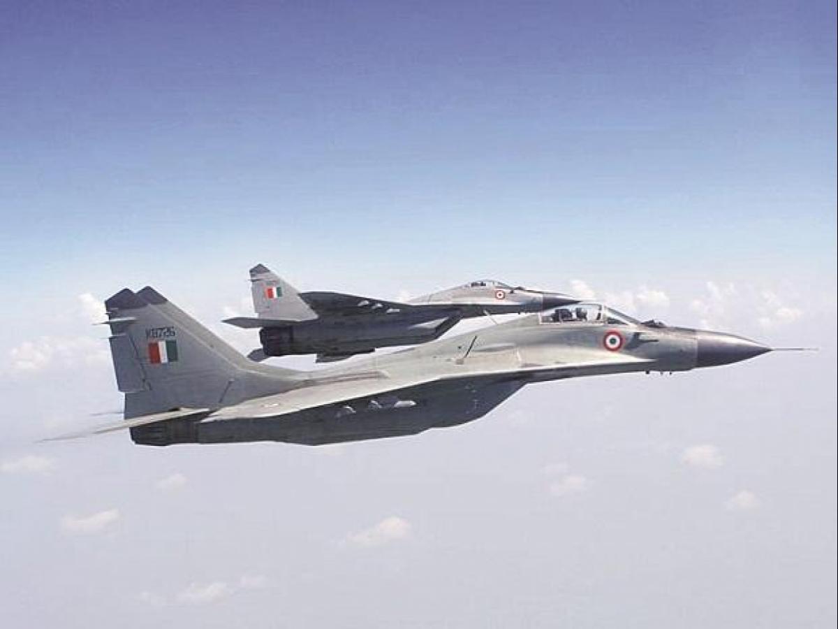

just a question
How does our mirage 2000 compare with mirage 2000 and mig 29?
I dont know how I can compare mirage 2000 with mirage 2000.
But for the Mig29, It's only defined and considerable edge over the mirage 2000 is a close range engagement where its superior performance, turn rate etc. would play a role. (Plus point for IRST)
And it could go either way for a BVR engagement tbh.
Mirage has better radar but the Mig29 has the better missile**
** though i dont know how much better astra is or if it is better at all compared to MICA. Its tricky since MICA is one of the few missiles to be both heat seeking and radar homing at once but Astra outranges it by 30-40 km.
Otherwise for anything else Mirage 2000 is simply a better platform.
It has considerably more payload and hardpoints (nearly 50% more), has better air to ground weapons, somewhat better targeting pod and is actually optimised for that role. Since its a multirole fighter rather than the air superiority role for the Mig29.
Indeed, this isn't just my opinion since during the kargil war Mig29s were used for escorting the Mirage 2000s performing air to ground missions.

I think the Zhuk ME of the Mig 29UPG is somewhat more powerful than the one in the Mirage.
It depends of the exact model of Mirage 2000.
In air to air : Mirage 2000-9 > Mirage 2000-5 mk2 > Mirage 2000-5 > Mirage 2000 C with RDI radar > Mirage 2000 C with RDM radar > Mirage 2000 D & N
In air to ground : Mirage 2000 D 1 N > Mirage 2000-9 & -5 > Mirage 2000 C
power is one thing, signal treatment another. I think the Thales radar are better in this field.
And in this equation you also have to weight the RCS of each (if they are opposed). Mig29 RCS > Mirage RCS.
Is it so sure ?
Instantaneous turn rate of Mirage 2000 is among the best (only exceeds by european euro canards).
That means that in a Mig29 to Mirage fight, as against a F16, Mirage pilot has to take the lead in the very beginning turns. If it failed after 3 or 4 turns, it has lost too many kinetic energy and will loose the match.
Why?
Not because the Mirage was unable to defeat pak fighters, but because they were THE SOLE indian fighter able to carry a laser guided bomb at such an altitude.
And at those time the Indian Mirage were fitted with RDM radars, and can't carry heavy air to ground ordnance + laser pod and medium range air to air missiles. With the RDY radar and MICA, Mirage 2000 can now carry air to air medium range and air to ground weapons.
Yep, they were simply better air to ground.
