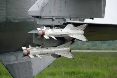

Just a question... can the ASRAAM missile on the right can be shifted on lower side increasing space for middle pylon to carry 2 missile
Something like this without the left side bomb.
ABSOLUTELY, it is plain madness to space them apart and at the same level as the middle pylon. (although remember that the pylons are spread out along z axis). With a missile like ASRAAM - so clean and with hardly any fins - this is an absolute travesty
You can do many things, assume pylon is at position p:
1. Diagonal like you showed - although the stresses are too high for AAMs.
2. The outboard p-1h-1x, the inboard at p-2h (x axis running along wingspan, h being height) - Gripen E does something similar with Meteor
3. Use side by side but pack them close, much more close - they are just being stupidly cautious with the spacing, or cant be asked designing new rail launcher and wanted to reuse existing.
